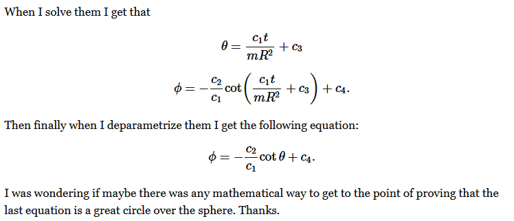

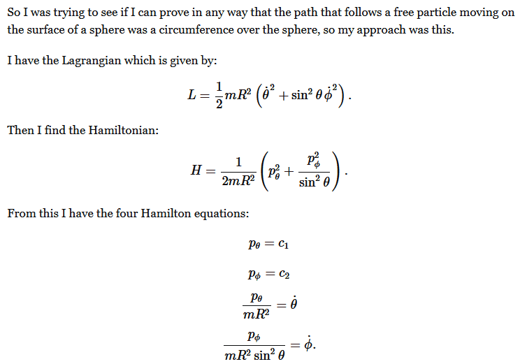

gordunox
Consider a particle of mass m whose motion is restricted to occur on the surface of a sphere of radius R. There are no other forces acting on the particle. Demonstrate that the motion occurs along a circle on the sphere.
$$\phi=-\frac{c_{2}}{c_{1}}\cot\theta+c_{4}$$
Try working from the other end, find the relationship between ##\theta## and ##\phi## on a great circle.
E.g. let ##\vec P## be a fixed point on a unit sphere and ##\vec Q## be ##\pi/2## away from it. Write each in Cartesian form but using spherical polar coordinates. The dot product is zero. This gives a relationship between the latitude and longitude of Q, the locus being a great circle.
(But the mix of angle and trig in your equation looks very unlikely to me. Maybe do a sanity check on special cases first; ##\theta=0##, for example.)

Check your equation for ##\dot{p}_\theta##.
You are right, that's the mistake. I will change the equation and see what I get.
