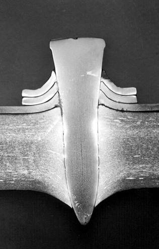

Friction is the main thing to overcome in that case, unless your stake hits solid rock.
Power actuated pins into steel beams are also hold in place by friction.
The normal force comes from the elasticity of the deformed metal into which the pin is forced.

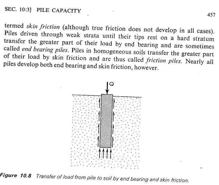

Since you are interested in stakes driven into the ground, ballistics calculations do not apply. Unless, of course, that stake is fired into the ground at high velocity. The forces to push a stake into the ground can be calculated using the methods of soil mechanics. This image, from Introductory Soil Mechanics and Foundations 3rd Edition by Sowers and Sowers is for piles, which are very large stakes.
The rest of the chapter goes into the details of calculating the total load the pile can support. That load is the same as the force to drive it deeper. The procedure is to separately calculate the force from skin friction and end bearing, then add the two forces. Since the force due to skin friction is proportional to the side area in contact with the soil, the force to drive the stake deeper must increase as the stake is driven deeper.
I see that the 4th edition of that book is available from Amazon. It's a good buy if you want to get deeper into the subject.
