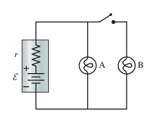

By what percent does the current through A change when the switch is closed?
I found the value of the current to be .174 A when the switch is closed and value of the current when the switch is open to be .181 A.
final-initial/initial
(.174A-.181A)/.181A=-3.86% but it says it wrong, and I did (.181A-.174A)/.174A =4.02% but this was wrong too. I've tried 3.87%,3.86%,-3.87%,-3.67%,4.02%, and -4.02% but all were wrong. I'm really not sure what to do here.
Is there a circuit diagram?

Circuit schematic of a battery with internal resistance r and emf labelled E, connected in parallel to two light bulbs labelled A and B, with a switch in the branch feeding bulb B.
Here you go!
Here is the actual problem; For an ideal battery (r = 0 Ω), closing the switch in (Figure 1)does not affect the brightness of bulb A. In practice, bulb A dims just a little when the switch closes. To see why, assume that the 1.50 V battery has an internal resistance r = 0.30 Ω and that the resistance of a glowing bulb is R = 8.00 Ω.
  • Circuit schematic of a battery with internal resistance r and emf script E, connected to two parallel light bulbs A and B, with a switch in the branch feeding bulb B.
