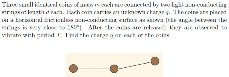

Period of three oscillating charged coins
The discussion revolves around the dynamics of three oscillating charged coins, focusing on their motion and interactions due to electrostatic forces. Participants explore concepts related to oscillations, center of mass, and energy conservation within the context of this mechanical system.

U = \frac{2 k q ^2}{l} + \frac{k q^2}{2 l cos \frac {\theta}{2}}
from that it is easily seen that equilibrium position is when the system is straight
so i was thinking the middle mass would move upwards and the left and right mass would move outwards
is that correct is my approach even correct in the first place? thanks

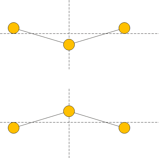

Left and right move downwards in your picture -- the driving force is somewhat outwards, but only the tangential component works toward equilibrium.
(actually, things happen in a frictionless horizonta plane)
For the kinetic energy you want to consider the motion of the center of mass -- or its absence ...
Compare with a simple pendulum.

The masses are constrained to move on circles with the middle mass as center point. The electrostatic force is a restoring force that tries to align all three masses -as you found already.
would that keep the center of mass in the same position ?
If the centre of mass is supposed to remain where it is then the middle mass can't be fixed the middle mass moves upwards and the upper masses move down to meet the lower mass at line of centre of mass before overshooting and continuing all over
Is this correct I can't just visualize the lower mass being fixed
Yes: the center of mass stays in place if the middle mass moves 'up' (in the drawing) twice as much as each of the outer masses moves 'down'. This is called a 'normal mode' for the system.
Yes that's what I meant so the upper mass tangential velocity can be approximated mostly as vertical right
Correct: the so-called small angle approximation (just like with a simple pendulum)

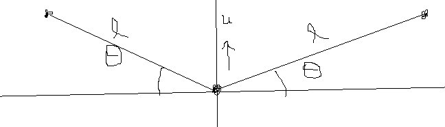

so this is what i have come up with so far
if the upper mass moves down with velocity v then the middle mass would move up with velocity 2v
y = l sin \frac{\theta}{2}\\
y \approx l \frac{\theta}{2}\\
\dot y = l \frac{\dot \theta}{2}\\
Ke = 2 \frac{1}{2} m (l \frac{\dot \theta}{2})^2 + \frac{1}{2}m (l \dot \theta)^2\\
Ke = m (l \frac{\dot \theta}{2})^2 + \frac{1}{2}m (l \dot \theta)^2\\
Ke = \frac{3m l^2 {\dot \theta}^2}{4}

##y = l sin \frac{\theta}{2}## is the ##y##-displacement between the middle coin and the end coins. But ##\dot y## is not the velocity of any of the coins.
TSny said:
OK
yup that's right been so oblivious to it sorry

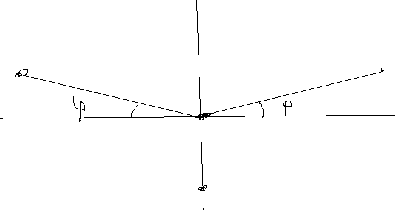

still need help to set up the new approach picking com as the origin theta as the angle between the line joining the com and the upper mass and the x axis.
how to get velocities of masses from this
Yes, put the origin at the center of mass in your figure of post #12. But keep ##\theta/2## as the angle of either string from horizontal. Actually, as BvU suggested, get rid of the factor of 1/2 by letting, say, ##\phi = \theta / 2##.
Can you express the vertical coordinates of the coins (##y_1##, ##y_2##, ##y_3##) in terms of ##\phi##?

that is exactly what i am not able to do i am missing some piece of geometrical information
what is the additional information i need
the distance of upper masses from com is constantly varying
meanwhile i was thinking since the previous result derived was flawed but i was wondering since the expression for ##\dot y## for the vertical mases is relative to the lower mass and we know the velocity of lower mass is half that of the upper masses can we work out the actual velocity of upper masses using the concept of relative masses
If the outer masses move by ##\ \Delta y = l\sin \phi \approx l\phi\ ##, how much does the central mass have to move to keep the center of mass in place ?
but the distance from centre of mass to outer mass is not l
I agree.
thats where i am stuck will my method of relative velocity approach in post 16 work
But for small angles, and that's what we are working with, it is.
