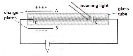

Hi there,
I have this problem with this photoelectric effect experiment.
In the image of my attachment particulates will be ejected from C and move to D. The electric field(by A and B) will change the particulates trajectory to A, B or will not change this?

Hi Tony! :smile:
(btw, we call them "particles" … "particulate" is usually an adjective :wink:)
the particles are negatively-charged electrons, so which way will they go? :smile:
the negatively charged photoelectrons will move towards the positively charged plate A as unlike charges attract each other.
I have a sneaking suspicion that cathode ray tubes are built with the deflection plates inside the glass for a good reason. What do you think?
