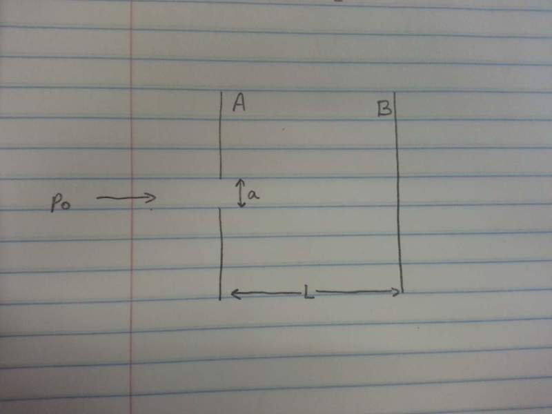

The diagram is attached. Photons are being beamed with momentum [itex]\rho_{0}[/itex] and mass [itex]m[/itex] at a slit of width A
Estimate the uncertainty [itex]\Delta p_{y}[/itex] emerging from A
Sketch spot size at B as a function of slit width using the uncertainty principle
Determine minimum spot size expected at B as a function of L and the deBroigle wavelegth [itex]\lambda_{0}[/itex]

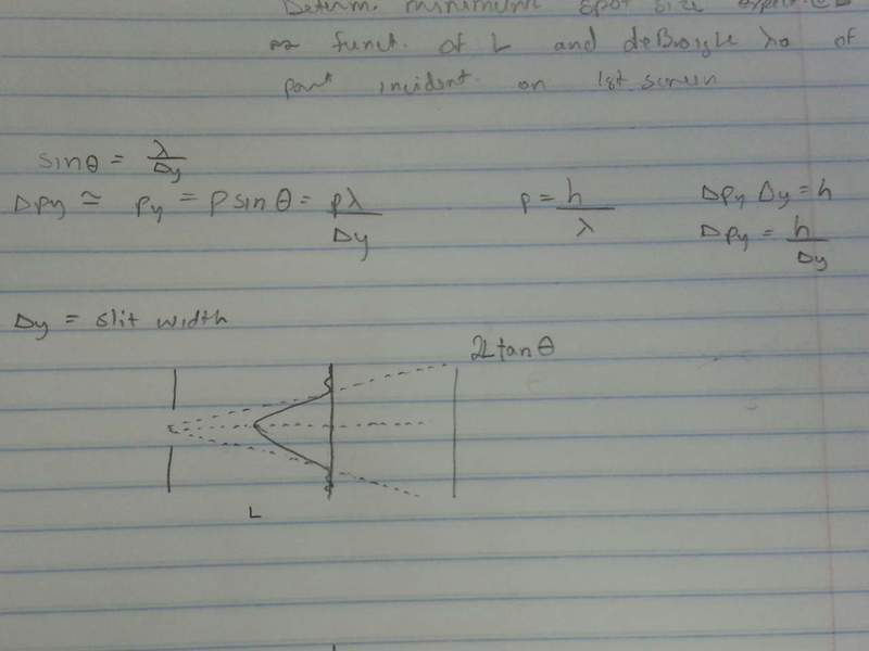

My attempt for part one is shown in image two. I achieved an answer of [itex]\frac{h}{\Delta y}[/itex]. [itex]\Delta y[/itex] is represented by [itex]a[/itex] in image one
Part two wants spot size as a function of width of slit - I found it as a function instead of L but I believe the sketch is relatively accurate. I'm not sure how to give it in the form it wants
Part three just throws me for a loop and I really don't have any idea

  • Hand-drawn diagram of a single slit: a plane wave or beam p0 moves rightward into a vertical barrier with a gap of width a, and a screen labeled B lies a distance L to the right.
  • Handwritten derivation on lined paper: sin θ = λ/Δy, Δp_y ≈ p_y = p sin θ = pλ/Δy, p = h/λ, and Δp_y Δy = h giving Δp_y = h/Δy; below, a sketch of a slit with a spreading beam of width 2L tan θ at a screen a distance L away.
For part 2, don't neglect the width of the slit - if the slit is very large, this is relevant. As a practical example, you do not expect a beam spot of some micrometers if the slit has a width of one meter (like a window). In addition, I think you should express theta in terms of the width of the slit and the wavelength.
If you fix that part, part 3 will make sense.
