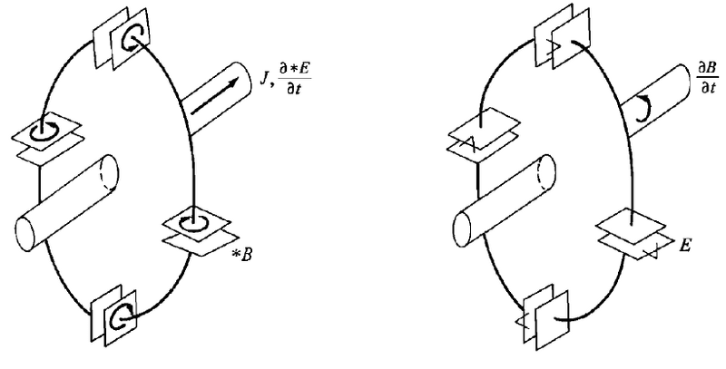

In the lower-right panel of my poster, I have drawn my renditions
of the magnetic covector field in Ampere-Maxwell Law
and the electric covector field in Faraday's Law
based on the visualizations of Bill Burke (in his Applied Differential Geometry book):
