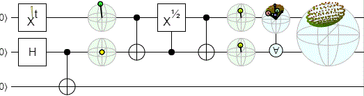

1. By randomly swapping between two qubits (e.g. controlled by a coin flip). This doesn't introduce any interesting entanglement between the two output:
The above is an animation of random-swap cloning in my simulator Quirk. The top qubit is the value to clone and set to various states along the ZY plane. The second qubit is the clone target and set to a mixed state by entangling it with the otherwise-unused third qubit. The fourth qubit is the coin-flip for whether to swap or not.
The green displays show the individual qubit values mapped onto the bloch sphere. The light-blue displays are showing how the qubits relate to each other. In particular, they show what the first qubit's state would be given for a nice covering of possible measurement axes / outcomes on the second qubit.
Notice that the right-most display is always showing a line. That's how you know the two qubits are only classically correlated: no matter where you measure one qubit, the other ends up along a single ray. Entanglement would look like a ball.

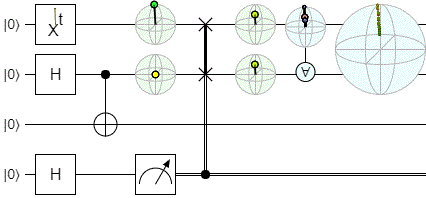

2. By doing a square-root-of-swap operation:
A bit better. There's entanglement now. But really we don't want entanglement, we want total independence. The closer we can get to that the better. Which leads to the known-optimal cloning method...

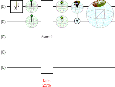

3. Projecting onto the symmetric state (and not counting the run if the projection fails):
Notice that there's still entanglement. However, the ball is smaller than before. We're closer to independence (i.e. perfect cloning). In fact, we're as close as we can get; this is the optimal approximate cloning method.

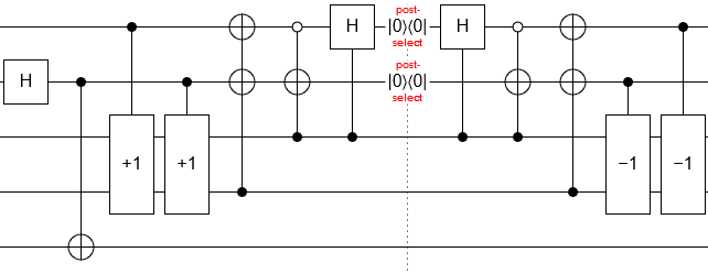

For reference, this is what's hidden inside the box:
What's happening: mix the clone-target qubit, count the input bits to figure out which symmetric basis state we should be in, un-prepare that basis state so that the top two qubits should be in the 0 state (unless we're not in the symmetric subspace), assert that we succeeded by throwing out runs where the top two qubits aren't zero, then re-prepare then and uncount.
