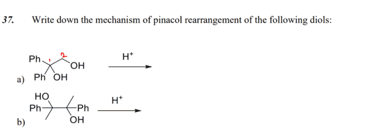

qkfqkekr
write down the mechanism of pinacol arrangement of the following diols
none
I have a question for the first part a), pinacol rearrangement of 1,1-diphenylethane-1,2-diol (did I name that right..?).
How would you know if protonation takes place on the hydroxyl molecule attached to carbon 1 or carbon 2?
My guess is that the hydroxyl group at carbon 1 would be protonated, since leaving of the hydroxyl group (as water) will yield tertiary carbocation, which is stable.
Is this approach correct?
Thank you for your help!
qkfqkekr said:
Homework Statement:: write down the mechanism of pinacol arrangement of the following diols
Relevant Equations:: none
If the hydroxyl group at carbon 1 was protonated, then which group would undergo rearrangement for the piñacolada to become piñacologne? I believe it needs to be the hydroxyl group on carbon 2.
