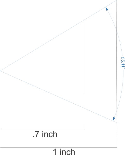

In the image, the angle is a static 55 degrees. At .7 inches there is less height than at 1 inch. At both, I want to know how many pixels that are 5177 nm in size can fit vertically at each position.

## 2 \tan(\frac{55.11^{\circ}}{2})=\frac{h_1}{.7 }## and ## 2 \tan(\frac{55.11^{\circ}}{2})=\frac{h_2}{1} ##. ## \\ ## Number of pixels=## \frac{h}{d} ## where ## d= ## pixel size. ## \\ ## The height ## h ## is in inches, so to convert to nanometers : ## h_{nm}=h_{in} \cdot 2.54 \cdot 10^7 ##. ## \\ ## Number of pixels=## \frac{h_{nm}}{d_{nm}} ##. (You need to have the units be the same for both ## h ## and ## d ## ). ## \\ ## ## h_1 ## is the case of a distance of .7", and ## h_2 ## is the case of 1". ## \\ ## I don't really see the application of exactly what the purpose of this calculation is, but perhaps what I gave you is helpful. ## \\ ## In the future, I would recommend that this type of calculation belongs in the homework section (even if it isn't exactly homework). ## \\ ## I am going to ask the Moderators to move this post to the Homework section. In the Homework section, it is a requirement to fill out the homework template. In addition, the student is required to work to the solution, rather than the Homework Helper providing the solution. (See Physics Forums Rules).

What is confusing here is that you are mixing angles and distances when there doesn't seem to be any actual connection. 5177nm per pixel is 4906 pixels per inch. Period. It doesn't matter if it's .7 inches away or .7 miles away.
...unless there is something else you aren't telling us, like that this is a projected image...?

What you're doing wrong is that there aren't 17,084,100 nm per inch. There are 25,400,000. Somehow, both of your calculations are getting this wrong, though one is much closer than the other. You don't need to use angles or viewing distances at all.
