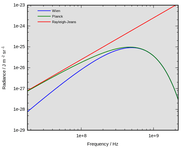

These look like they might be relevant
http://en.wikipedia.org/wiki/Planck's_law
Max Planck originally produced this law in 1900 (published in 1901[12]) in an attempt to improve upon the Wien approximation, published in 1896 by Wilhelm Wien, which fit the experimental data at short wavelengths (high frequencies) but deviated from it at long wavelengths (low frequencies). The Rayleigh-Jeans law (first published in incomplete form by Rayleigh in 1900[13]) fit well in the complementary domain (long wavelength, low frequency). Planck found that the above function, Planck's function, fitted the data for all wavelengths remarkably well.
Contrary to another myth, Planck did not derive his law in an attempt to resolve the "ultraviolet catastrophe", the name given by Paul Ehrenfest to the paradoxical result that the total energy in the cavity tends to infinity when the equipartition theorem of classical statistical mechanics is (mistakenly) applied to black body radiation. Planck was aware that the free electromagnetic field, in a cavity with perfectly reflecting walls and containing no ponderable matter to transduce energy between frequency components, cannot exchange energy between frequency components[19] and so is not within the scope of the classical principle of equipartition of energy, which it accordingly neither obeys nor violates.
The Wien approximation may be derived from Planck's law by assuming hv >> kT. When this is true, then
the Blackbody Radiation expressed in terms of frequency ν = c/λ in the limit of small frequency:
http://en.wikipedia.org/wiki/Wien_approximation
Wien's approximation (also sometimes called Wien's law or the Wien distribution law) is a law of physics used to describe the spectrum of thermal radiation (frequently called the blackbody function). This law was first derived by Wilhelm Wien in 1896.[1][2] The equation does accurately describe the short wavelength (high frequency) spectrum of thermal emission from objects, but it fails to accurately fit the experimental data for long wavelengths (low frequency) emission
http://en.wikipedia.org/wiki/Rayleigh-Jeans_law
The Rayleigh–Jeans law agrees with experimental results at large wavelengths (or, equivalently, low frequencies) but strongly disagrees at short wavelengths (or high frequencies).
http://en.wikipedia.org/wiki/Ultraviolet_catastrophe
The ultraviolet catastrophe results from the equipartition theorem of classical statistical mechanics which states that all harmonic oscillator modes (degrees of freedom) of a system at equilibrium have an average energy of kT.
According to classical electromagnetism, the number of electromagnetic modes in a 3-dimensional cavity, per unit frequency, is proportional to the square of the frequency. This therefore implies that the radiated power per unit frequency should follow the Rayleigh-Jeans law, and be proportional to frequency squared. Thus, both the power at a given frequency and the total radiated power is unlimited
http://en.wikipedia.org/wiki/Equipartition_theorem#Potential_energy_and_harmonic_oscillators
Equipartition applies to potential energies as well as kinetic energies: important examples include harmonic oscillators such as a spring, which has a quadratic potential energy

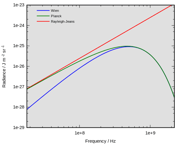

from this I get:
(2kT/λ²)(hf/kt)(1/e^hf/kT - 1)
λ² would be the area that a single photon covers​
