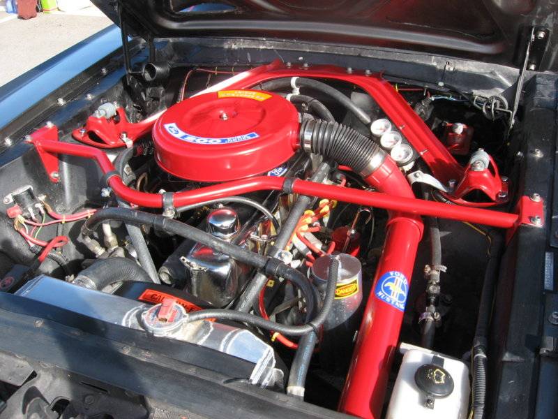

After retiring I build just for me, but I still answer questions for the M6A group on-line. After decades building V8's I find the little 4 and 6 cylinder engines challenging. It looks like most who own first generation Mustangs feel the need to upgrade the ignition in the old Pony. I have been there and never found the so-called upgrades to gain anything in the real world.
I tried to post a picture of my 65 SIX engine...without success...I think?
