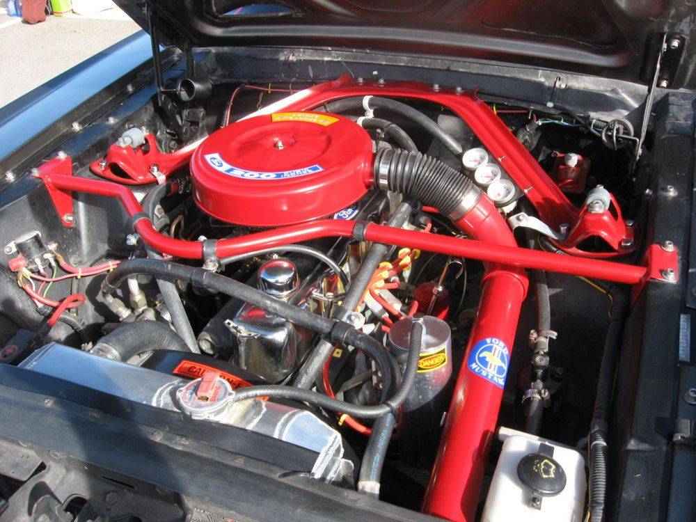

I am building a 1973 Ford 200" inline 6-cylinder, for my 65 Mustang. Because I drive it cross country to Rod Runs (car shows) I am looking for the best MPG not max HP.
The block will be .030"over, with .040" off the head to get the bigger cc chambers back close to the 51cc chambers in the 65 head. The later head has 62cc chambers. I'll take .010" off the block which has .019" deck height to further raise compression due to the 6.5cc dish of the pistons. The pistons are either 13cc, 6.5cc or flat-top. I am shooting for about 9 to 1 static and 8 to 1 dynamic for today's ethanol 89 octane gas.
This is a road-runner car built for long stretches of 500 to 700 miles a day, with the Air Conditioner running, the radio playing my recorded music while the wife reads her book. We have done this for decades in much older Street Rods (32 Ford 5-window/40 Ford coupe-both 289 V8 power), so this is not new to us.

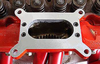

The carb is a 2100 Autolite 2-barrel with annular atomization with the cast-to-head 1-bbl intake machined to fit a 2-bbl directly on the intake. The ignition is home-built with Pertronix trigger, 36 degrees total advance, BWD Select parts, MSD low resistance (1 ohm) ignition resistor, ACCEL coil (42Kv Max, 1.4 ohm primary, 100-1 windings), Wire Wound resistance plug wires, and Autolite platinum plugs set at .040"gap.
The exhaust has been modified eliminating several bends and replacing the restrictive muffler with a 24" straight-thru glass-pack. Timing is 12 degrees with vacuum disconnected. All the info I find on-line is for MORE POWER and torque is seldom mentioned.
Unless I am barking up the wrong tree, Torque should relate to MPG better than HP, if it is made at cruising RPM's. Cam specs are listed as 256 duration, 366 lift, 28 overlap, 112-108 separation for my present choice hydraulic cam. I get 24.5 in this situation now with the 65 bored .060, and that is not recommended but was necessary due to #6 broken ring...and why a new-er motor.
Is my Torque thinking correct? Are there cam profiles one should look for to get more torque, and what role do lift, overlap, lobe separation, duration play in relation to Torque? I am talking on-the-street driving. Obviously I am dumb in this area, though I have built many engines, 95% being stock or minor modification. THANKS in advance.

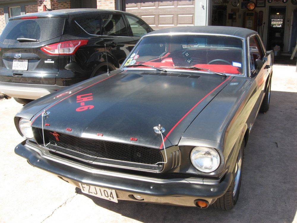

I think my chosen cam is okay for my purpose...without an overdrive. If I can fit the A4LD I will probably go down one size in rear tires. Right now I am torn between doing a complete rebuild of the 65 Mustang or put my $$ into my 67 Sunbeam Alpine with a Ford 2.3 and overdrive, and it has a removable hardtop. At 76 years I must narrow down my building work. The 65 Mustang may go up for sale this winter with the extra 73 motor and C4 thrown in because the 65 still runs good. In fact the wife and I are scheduled to go to Mississippi and Louisiana October in it for a show, and I am making a list of work done to the 65...just in case a buyer is there. In a previous post I have a pix of it in front of my house and the LH-6 can be seen on the hood. It stands for Long Haul 6-cylinder.
