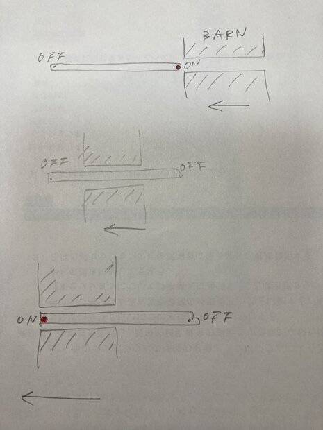

In post #8 I find no moment that two sensors at ends of rods are ON simultaneously in rod IFR.
The sensors attached to the rod would not be at the ends of the rod. They would be at a separation of the apparent width of the barn in the rod frame, anywhere along the rod. In the rod frame, it makes no sense for the sensors to be at the ends of the rod
