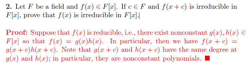

Joe20 Messages 53 Reaction score 1 Thread starter Mar 18, 2018 #1 I would like to have verification if the following attached proof is correct. If it is not correct, what can be done to make it correct? Thanks. Attachments pp.png 15.4 KB · Views: 111
I like Serena Science Advisor Homework Helper MHB Messages 16,335 Reaction score 258 Mar 19, 2018 #2 Alexis87 said: I would like to have verification if the following attached proof is correct. If it is not correct, what can be done to make it correct? Thanks. Hi Alexis87, It looks all correct to me. For clarity I would just add a final sentence saying that therefore f(x+c) is reducible, which is a contradiction.
