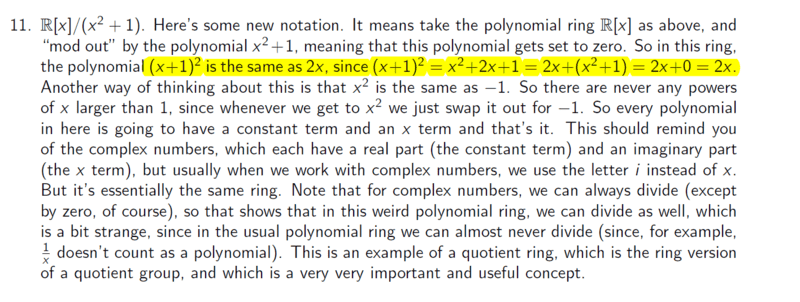

Kindly see attached (reference is highlighted part)
Its a bit clear; i can follow just to pick another polynomial say
##(x+1)^3## are we then going to have ##(2x-2)+ x+3##?
or it has to be a polynomial with
##x^2+1## being evident? cheers...
Let's see ...
\begin{align*}
(x+1)^3&=(x+1)^2\cdot (x+1)=2x\cdot (x+1)=2x^2+2x=2\cdot (x^2+1) -2+2x=2x-2=2\cdot (x-1)\\
&\text{crosscheck}\\
(x+1)^3&=x^3+3x^2+3x+1=x\cdot (-1)+3\cdot (-1)+3x+1=2x-2=2\cdot(x-1)
\end{align*}
We identify ##x^2=-1.##

...I was getting a bit lost on this line:
$$2x^2+2x=2\cdot (x^2+1) -2+2x=2x-2=2\cdot (x-1)$$
...but i now i got it by letting,
##x^2+x=x^2+1+m##
therefore
##m=x-1##
other steps follow well.
...which means that
##(x+1)^4=(x+1)^2 (x+1)^2 =2x ⋅2x=4x^2=4(-1)=-4##

Lastly on this just to get the drift of things, if we have a polynomial say;
##x^3+4##
then this becomes,
##x(x^2)+4=x(-1)+4=4-x##
##x^3+4##
then this becomes,
Right. The ring ##\mathbb{R}[x] ## is an integral domain, the ideal ##\langle x^2+1 \rangle## is prime and maximal. This makes ##\mathbb{R}[x]/\langle x^2+1 \rangle ## a field, the complex numbers. So ##x= \mathrm{i}.##
Here we have ##x^3+4= \mathrm{i}^3+4=-\mathrm{i} +4 =4-x.##
