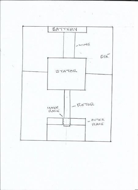

Hi, I wonder if someone can help with the following problem? We have a sealed box in space and inside the box is an electric motor with the stator attached to the box. The rotor arm is attached to the inner race of a bearing and the outer race of the bearing is also attached to the box.
There is an internal power supply. We know that when the power is applied to the motor, the stator will begin to rotate in the opposite direction to the rotor arm and the outer race will rotate in the opposite direction to the inner race and so will apply a torque to the box in the same direction as the stator.
Will the stator and rotor rotate in balance?
Will the rotor arm rotate faster than the stator so that the outer race will always apply a small torque to the box?
Will the rotor arm slow so that the outer race now starts a reverse effect on the rotor arm?
None of the above.

Diagram attached
So the stator, box, and outer race are all rigidly attached to each other, and the rotor and inner race are rigidly attached to each other?
That is correct.
So the stator + box + outer race will rotate in balance with the rotor + inner race.

Angular momentum is conserved. So there is no uni-directional torque. Any torque is accompanied by an equal and opposite torque. Just like forces with newton’s 3rd law
chazemz said:
If the box can counter rotate faster than the rotor, a crossover point should be reached and the bearing will now apply a toque to the rotor not the box.
I don’t think so. I cannot see any physical justification for such a crossover point
The ball bearings between the inner and outer races change the direction of the torque of the rotor. It is impossible for the rotor in the diagram to apply a torque to the box. Even though everything is connected to each other a torque is applied to the box in one direction only. May I also add that the box will spin and therefore interact with its surrounding which will introduce an exterior force. Conservation of angular momentum applies in a closed system.

This is a classic closed system. There is no external torque, no exterior force, and no interaction with the surrounding. All by your own stipulation that this is a sealed box in space.
No. Ball bearings allow inner and outer races to rotate relative to each other with minimal friction between them. That's all that they do.
No. A motor inside a box that is applying a torque, will apply a torque to the box. The direction of that torque depends on whether the box is connected to the motor rotor or motor stator. The amount of that torque depends on the rate of acceleration and the relative inertias.

A sealed box in space, by definition, has no exterior force. In a physics problem such as this box in space, we assume zero friction, zero magnetic fields, zero atmosphere, zero sunlight pressure, and zero external influences. Any exceptions are clearly and specifically stated.

Pure nonsense. A motor can accelerate in either direction, therefore motor torque is bidirectional. A motor that applied unidirectional torque, by definition, would accelerate to a speed and never slow down.
chazemz said:
What I am interested in is how this would change the dynamics between the rotor and stator?
The dynamics are simple. Apply current >> motor accelerates or decelerates depending on how the current is applied. An observer sitting on the stator will see the rotor change velocity, but will not know if the rotor, stator, or both are rotating with respect to the outside world.

That is not at all how they work. Bearings work to not transmit frictional torque. They are ideally a connection with 0 frictional torque. That in no way implies that they rotate in opposite directions.

Since the exterior force is negligible by your original stipulation, all of the replies assumed that. With that assumption it is not unknown. The system does come to rest at the end.
With non negligible drag the system comes to rest with respect to the fluid at the end.
