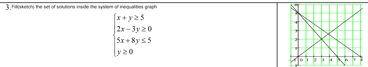

Hello, so there's a graph provided in the task which I'm trying to solve for a quite a while and I am really confused where the 5 to 8 line came from, because (5x+8y<5) doesn't create that sort of line. Is it possible that there's a misstake done by my teacher or am I understanding something wrong?

It certainly looks like a mistake. If the diagram is meant to illustrate the inequalities then the third inequality should be $5x+8y\le40$.
