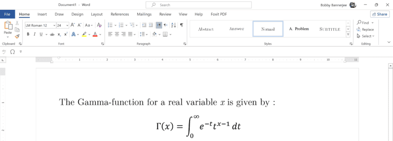

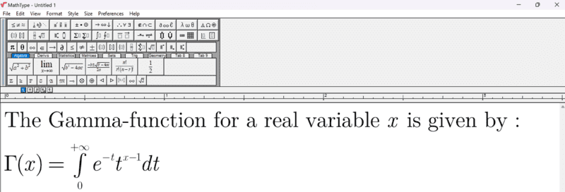

Actually there's both today @pasmith. I have them. But neither is as good as the one on the video.
Equation editor uses the Cambria Math font, which is not as good as the Latin Modern Roman Font in ##\rm{LaTeX}##. Or the Computer Modern Roman font.
In MathType, you can install and load those fonts but they are not as clean as the way it appeared on the video.
Here's a screenshot from MathType :
Here's a screenshot from MSWord's Equation editor :
As you can see, the Cambria Math font of MSWord doesn't have the nice look of the CMR one of ##\rm{LaTeX}##. However, both Equation Editor and MathType can be used to type in real time. MathType has the advantage of better shortcut keys so as to avoid the commands being shown.
