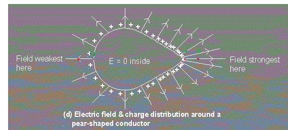

As shown in figure, we know that at the sharp end E field is strong, and at the other end field is weak.
Inside the conductor E=0. that means V=constant. on its surface and throughout the conductor.
if we move unit positive charge from B to A or P to Q (as shown in fig.) then different amount of work will have to do to bring this charge (because field intensity is different at both the ends).
(assumed distance between PQ = distance AB)
According to the definition of Potential,
Work done (against the field ) to bring unit positive charge from infinite distance to point in the electric field is called electric potential at that point.
Here, Work done will be more to move B to A rather than P to Q because field is strong(at B to A) therefore more work will to do.
So the potential is different at point A and at point Q?(it is not the same throughout the conductor.)
If i wrong please correct me...

The drawing is not quite clear. Are A and Q inside the conductor or outside?
They are just on the outer surface of the conductor.
Then they are not equipotential, I believe.

But when you put the charges on the conductor, the charges distributed on the surface of conductor such that it acquires the same potential ( charges moves on the surface from higher potential to lower potential until whole surface becomes equipotential.)
Just inside the surface is equipotential, but just outside the surface is not equipotential. I am unsure about actually on the surface.
Dale said:
Inside the surface is equipotential, but just outside the surface is not equipotential. I am unsure about on the surface.
As point A and Q are just outside(A and Q are very close to surface) the surface , the potentials are not same. But as we move on surface potential becomes equal.
I don't understand this phenomena.

But here on both sides gravitational field is same and same height will have to covered. Means same energy used.
But here on both sides have different electric field intensity means different amount of work will have to do.
Yes, if they are just outside then they are not necessarily equipotential.

I don't see your problem. Points A and Q may have the same potential (if they are on the surface) but P and B have definitely different potentials. So the potential difference between B and A is not the same as between P and Q. So the work done in the two situations is different even though the distance is the same. There is no contradiction.

According to @rumborak , The potential at points P and B may have different. But the potential difference between B & A and P & Q should be same. because the work done in the two situations is same.
No, this is not correct. The work done would be different.
Go back to the definition of work and check if something is different for the two paths.

Work done :
W(Infinity to P)+W(P to Q) = W(infinity to B) + W(B to A)
I don't see any contradiction.

Your equation must be true if the potential at Q and A are the same. But since W(P to Q) < W (B to A) as the field between B and A is stronger than the field between P and Q, it implies W(∞ to P) > W(∞ to B). Can you provide a reason for this?
Infinity in case of potential is arbitrary (V=0). So i guess Workdone in bringing to P and B might be different.
E= -(dV/dr) so potential will drop differently in both directions, making V=0 at different 'infinities'.
(Note: Don't take infinity literally).
Correct me if I'm wrong.
Universeer said:
So i guess Workdone in bringing to P and B might be different. E= -(dV/dr) so potential will drop differently in both directions...
Yes, it must be that W(∞ to P) > W(∞ to B) but I was just trying to see if someone could come up with a hand-waving argument for what Rumborak said: "The weak field will extend further out, so in the end you expend exactly the same energy as pushing it from the pointy side where the field is strong (but doesn't extend as far)."
