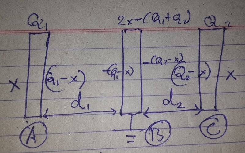

A few rules are commonly taught when dealing with problems regarding charge distributions of multiple charged plates/sheets at specified distances from each other(the sheets have infinite size) -
  • Any two sheets facing each other must have opposite charges equal in magnitude on the inner faces
  • The outer-most faces of the outer-most sheets must have charge equal to half the sum of all the charges distributed on all plates
  • When any one sheet is "grounded", the sum of the charges of all plates becomes zero, thus the charge on the outer-most faces of the outer-most sheets is also zero
These rules can be easily derived from the fact that conductors cannot have electric fields inside them as shown here - electrostatics - Why are the two outer charge densities on a system of parallel charged plates identical? - Physics Stack Exchange & electrostatics - Grounding system of conducting plates - Physics Stack Exchange
Now for my question, what exactly would grounding mean in such a system? Is it at 0V with respect to something? Or did we assume it as our reference potential? If we did the latter then I think the solution to these problems would also depend on its "absolute potential" as in say we have n plates with charges ## Q_1 , Q_2 ,..., Q_n ## and we connect one of these to a conducting hollow sphere far enough that it is not affected by the fields of this system. This is our ground. Then depending upon its potential(##\frac{kq_{sphere}}{R}##) wouldn't the sum of the charges on all the plates differ from zero? If it had a very high potential then it would force positive charge into the plate even if ## \sum Q_i ## was already positive. This could be done even while respecting the ## E=0 ## condition of all the plates. eg -
By varying x in these any amount of positive charge could be delivered into B while also having the fields cancel out inside of all conductors.
Tl;DR - explain a ground's potential and function in the context of infinite charged plates and prove that the sum of charges of all plates must be zero if one of them is grounded.

When none of the plates is grounded, there will be charge on the outer surfaces of the outer plates, in general. So, there will be a uniform electric field that extends to infinity from the outer surfaces of the outer plates. It will be impossible to introduce a conducting hollow sphere far enough away to be unaffected by these fields. Also, there will not be a definite value of potential "at infinity". So, defining "grounding of a plate" as setting the potential of the plate to some value is not going to be meaningful (I believe).
For a system of finite-sized conductors, we can take the potential "at infinity" to be zero and define grounding a conductor as setting the potential of the conductor to zero. I believe you can show that the final charge on the grounded conductor is such as to minimize the total electrostatic energy of the system with respect to varying the charge on the grounded conductor.
For the system of infinite plates, I would interpret "grounding a plate" to mean that you allow the charge on that plate to assume the value that minimizes the total electrostatic potential energy of the system. This was mentioned in your links to Physics Stack Exchange.

That is something I did not understand while reading that answer on stackexchange, how does making the potential of a plate zero(w.r.t. infinity) correlate with its energy getting minimized? I don't even know if the problem is answerable as it would be hard to calculate the potentials of finite plates w.r.t. infinity(let alone set one to zero) due to the fringing fields as they are finite sheets. Plus, wouldn't the solution of minimizing energy only work for grounds with a potential w.r.t. infinity of 0? What if we connected it to my hollow charged sphere?

Also, is it necessary to take ground as a potential reference every single time? The way I see it, grounding a body just means connecting it to a large conducting body kept far away, like the earth. That is a physical process, while assuming that body's potential as 0 volts is just semantics. Am I wrong?

Here are some comments about potentially (ha ha) ambiguous terminology...
1. In some contexts, ‘ground’ (or ‘earth’ or ‘chassis’) is simply used to mean a convenient fixed voltage reference level, taken as 0V, in a circuit. E.g. the negative terminal of a car’s electrical system.
2. In some contexts, 0V is taken as the potential at infinity (where the electric field from all charges is zero). But this is not then referred to as ‘ground’.
3. In some contexts, ‘ground’ refers to the earth’s surface – treated as a conductor at 0V; connections to ‘ground’ are used to facilitate electrical safety.
4. In some contexts, where current is required to flow between some apparatus and ‘ground’ (such as the plate being "grounded" in Post #1), there is an implicit requirement that ‘ground’ must remain at a constant potential (which is taken as 0V for convenience). Ground can then be conceptualised as a plate of an ideal infinite capacitor – charge can enter or leave it without changing its potential (as you suggested in Post #5).
(Note that the earth itself, if treated as a conducting sphere, has a capacitance of about ##710 \mu F## which is surprisingly small.)
The above is not meant to be rigorous/complete – it's just for clarification.

I do believe that EE says that grounding any point(just one though) will not change the distribution of charge through the system. I mean, we do that with the neutral wire in power distribution too. Every transformer has one end of its secondary loop connected to ground and it doesn't change anything about the circuit. Of course now that the neutral is at ground potential it does change some other things around. As in say I touch the neutral wire and if everything is working as intended I won't get shocked. If the circuit were floating, I would. We could also ground the "live wire" and then the dangerous one would be the neutral wire with a negative potential difference to ground...I think that was done with some early telegraph systems(though they were DC, but my point still stands).
I don't think that a grounded conductor is required to be neutral. It takes on the charge distribution that minimizes it's energy(I've finally understood @TSny 's argument!) which might or might not make it neutral. Could you explain why you think so?

I agree with all of those statements, but I was actually trying to say that the potential of the ground is important in determining the final state of a charge distribution and that taking it as reference just means we can say that ##V_{\infty} = -V## where ##V## was the potential of the ground before. The final state now depends on the potential of ##\infty## w.r.t. our infinite coductor so it's still the same condition but written in a different form ie semantics.
