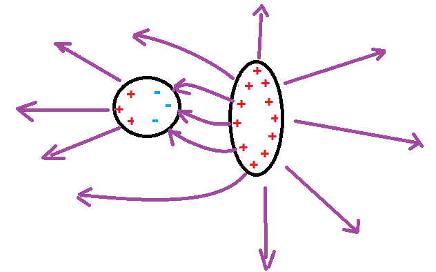

The potential of a conductor is the same everywhere inside and on the surface. The electric field lines emerge from charges and end in charges or in infinity. The potential drops along a field line, the gradient of potential is opposite to the direction of the field line. What do you say about the potential of the uncharged conductor with respect to the charged one? What do say about the potential of the conductors with respect to infinity?

Since field lines emerge on charged conductor and ends on negative charges on uncharged one , potential of charged is higher . Again field lines emerge on both the conductors and end up at infinity .Hence , potentials of both the conductors are more than that at infinity . Option 4 ) is correct .Makes sense ?
Yes. I hope it is correct. :smile:

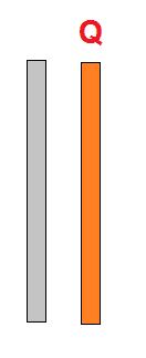

I would not be so sure. Look at the system in the figure:
Diagram of two vertical parallel rectangular metal sheets: a grey sheet on the left and an orange sheet on the right labelled Q in red above it.
These are to identical metal sheets, with lateral sizes much larger then the distance between them. One is charged, the other is neutral. What is the electric field around the charged one if it is alone? You bring the uncharged sheet in, close to the charged one. What is the electric field to the right of the charged one, between the sheets and to the left of the uncharged one?
Vibhor said:
The electric field in every case is σ/ε0.
Not quite if σ is the charge per unit area. But the electric field is the same in both cases. Assuming the potential zero somewhere far away, does it change at the charged sheet if the uncharged one is placed near to it?
