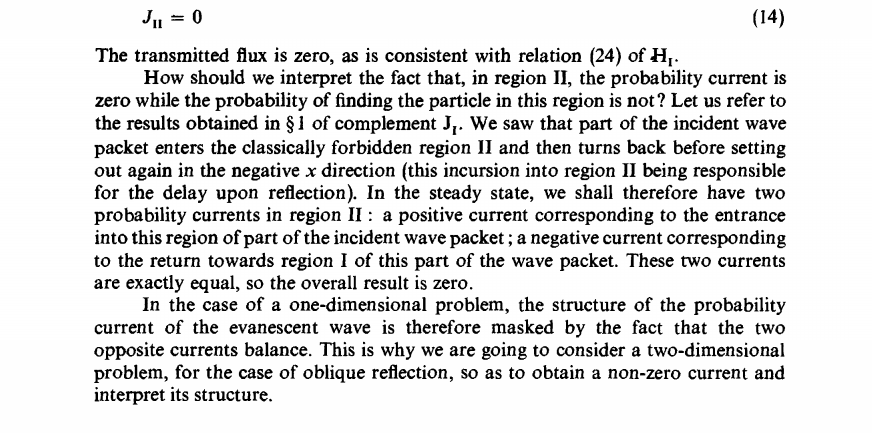

We know that thanks to the tunnel effect, in the case of a finite potential step (V) and considering a stationary state, when a plane wave with energy E < V encounter the step the probabability that the wave-particle coming from -∞ (where potential is V=0) will be ≠ 0, in particular the wave function will be exponential decay. We can also calculate the probability flux (J) through the potential step and the result is J=0. In my book i read that taking into account all these results, the interpretation that we can give is that considering many particles, a certain percentage will cross the step and after a definite amount of time it will turns back before setting out in the direction where it came from, this vision allow us to justify why J=0. Here is my question: once (and if) the wave-particle cross the potential step, shouldn't continue its path without turning back? There is a cause that force it to reverse the direction and that can be explain from an "intuitive" point of view?

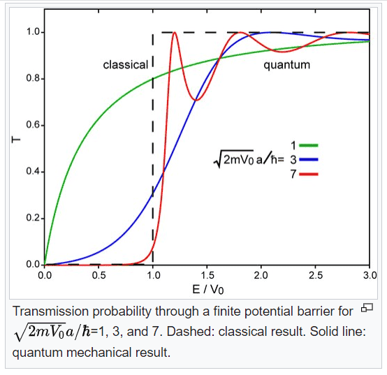

Would this be for ##x>a## in the Wikipedia casus ? Or only inside the barier ?

I'm referring inside the barier, but in the case of a step potential like in the picture:
Particle incident on a step potential. | Download Scientific Diagram

Ah! Based on the terms 'tunneling'and 'through', I took the barrier example.
I think you are referring to
And that suggests a path through region II for the whole wave packet -- the 'particle'. I find it slightly misleading (but correct). Note that the x-momentum in that region is imaginary !
Re 'shouldn't continue its path without turning back?' No. The wave function decays exponentially and the momentum is imaginary. J = 0. Why should it ?

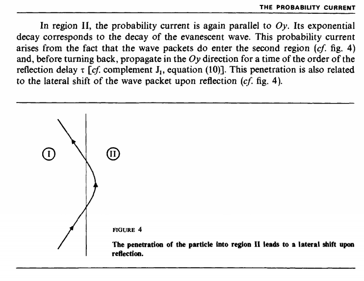

@vanhees71 : What do you think of fig 4 in post #3 ? Is it exaggerating <x> venturing into x>0 ?
I don't know, how to read this figure (I think you mean #4, right?). The modulus-squared wave function tells us the probability distribution for the position at time ##t##. Why Cohen-Tanoudji draws a trajectory I don't know.
vanhees71 said:
you mean #4, right?
Yes, sorry. I have the feeling <x> stays well within x<0 and am curious about the relationship with the Heisenberg uncertainty (but too lazy/not handy enough to work it out in detail)
