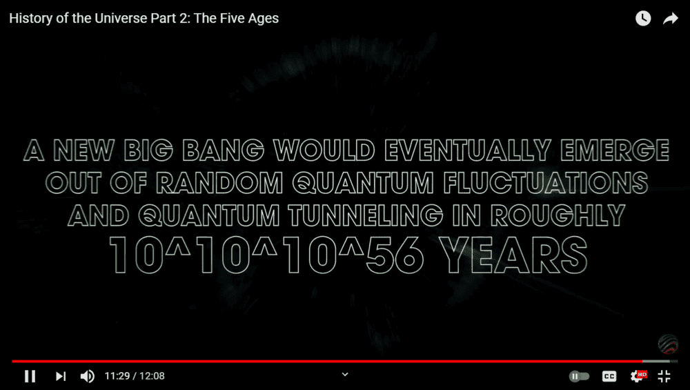

Dear PF Forum,
I watched this video
10 ^ 10 ^ 10 ^ 5600
The narative says,
It is 1 followed by 5600 zeros
But that's not what I think,
I think it is 1 followed by I don't know.
What does this number means?
Is it
A: 10 ^ (10 ^ (10 ^ 56)))
or
B: ((10 ^ 10) ^ 10) ^ 56?
It says that
"As another possibility, during the dark era, the extreme low energy states might cause the localized quantum events to become major microscopic phenomena. At that point the smallest pertubation might lead to enormouse changes. In their paper spontaneus inflation and the origin of arrow of time, Sean Caroll and Jennifer Chan have calculated that the new Big Bang would eventually emerge out of random quantum fluctuations and quantum tunneling in roughly in ten to the power of ten to the power of ten to the power of 56 years.
That's one followed by 5600 zeros"
Well, is it 1 followed by 5600 zeros or (10 ^ (10 ^ 56))) zeros?
And judging from the physics involved, which one is true?

My guess is A ##10^{10^{10^{5600}}}##

KingGambit said:
Is it
or
So when we write something like:
##\omega##^##\omega##^##\omega##^##\omega##
by default (if nothing else is mentioned) it usually is taken to mean:
##\omega##^(##\omega##^(##\omega##^##\omega##))=##\omega^{\omega^{\omega^{\omega}}}##
and not:
((##\omega##^##\omega##)^##\omega##)^##\omega##=##\omega^{\omega^3}##
One would guess that it should be similar for finite numbers too.
It's taken to mean choice A.
As an example, if three is used instead of ten:
3^(3^3) = 3^27 = 7.62559748499e+12
-vs-
(3^3)^3 = 27^3 = 19683
