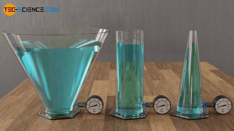

For this problem,
The solution is,
However, I thought the answer would be (b) and (e). I choose (b) because from the formula ##P = \frac{F}{A}## then since the vessel A has more water, then the water will have a larger weight ##W_A > W_C > W_B##, therefore from##P = \frac{mg}{A}## we conclude that since the area is the same for each vessel then ##P_A > P_C > P_B##.
I choose (e) because I thought the pressure on the sides of A would be greatest since from each value of ##h## below the water, there is more water above in A since it circumference is largest at the top and decreases.
Could someone please why my answers is not correct?
Many thanks!
Yes, vessel A has more water. The vessel is supporting more total weight of water. But the walls of vessel A are providing part of that support.
Think about an imaginary partition that separates the portion of the water above the sides from the portion of the water above the bottom. The water is at equilibrium either with or without the partition. Nothing is flowing anywhere. We can replace the imaginary partition with a rigid wall and nothing changes. But that just leaves us with a cylinder of water. Clearly the pressure on the bottom relates only to the depth of the water.
Just as Pascal's principle requires.
More water. More total force from the weight of that water. But some of that force is spread over the sloping sides above the given depth. Again, we could apply the partition argument and ignore both those sloping sides and the extra water above. Again, what does Pascal's principle say about the pressure of water at a given depth?

It seems that someone did the experiment. Look at the pressure gauge readings.

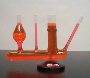

A related demonstration is the "connected vessels". If the pressure at the bottom of a vessel were different (say higher) than the others, fluid would flow out of it and lower its level. Also, as you can see, the cross sectional area at the bottom is irrelevant.

Note that if the levels were not equal one could construct a perpetual motion machine.

I think "d" (the force on the bottom of each vessel is not the same) is worth discussing. I would say the net force on the bottoms is the same: zero in every case (since the bottoms are not accelerating). Also, the water pressure at, and the area of, the bottoms are the same, so the force (P*A) on the bottom is the same. But the downward force at the "rims" of the bottoms - they're different aren't they? If you put these vessels on three scales, you'd see A is heavier than C, and C is heavier than B.
