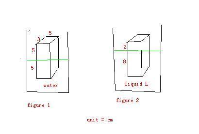

consider the figures 1 and 2 which show two identical, rectangular wooden blocks
Weight of the block:
Pressure = F/a
Pressure = Density x gravity x height
The weight of the block,
i have tried to find the pressure of water of figure1
pressure = p g h = p = 1000 x 9.8 x 0.05 = 490 N/m^2
but i do not have any idea of what to do after.
thank you very much

There is no need for finding pressure. Find the buoyant force
the buoyant force = V p g ...
the buoyant force = to the force exerted by the object.
therefore times the buoyant force by two, Because it is exact half submerged ?

Yes, but that's no way to prove it :redface:
you need to write an equation, weight + buoyant force = 0.
(btw, you could have used pressure … the upward force from the water is the pressure times the area of the base … but buoyant force is more sensible :wink:)

F= Pa = p g h * A
the the pressure there is always referring to Pressure of liquid right ?
however i think i have made a mistake ...
for F= V p g <-- the volume should be the volume of the object which submerged in the liquid right ?

is ρ here the density of the block or of the water, and is this supposed to be the buoyant force or the weight?
lets just stick to the first equation ;)
F = V p g
and what I'm wondering is F = upthrust ,
V = volume of object submerged in liquid OR volume of the block?
p = density of liquid
g = acceleration due to gravity
am i right ?
The upthrust is the weight of the liquid displaced, which is the density of the liquid times the volume of the liquid displaced (ie the volume of the object submerged). :smile:
ok thanks ... thank you. ill have to time the upthrust by 2, because the object is only half submerged ... right ?
The upthrust is the upthrust, you don't "times" it by anything, you add it to the weight to get zero.
