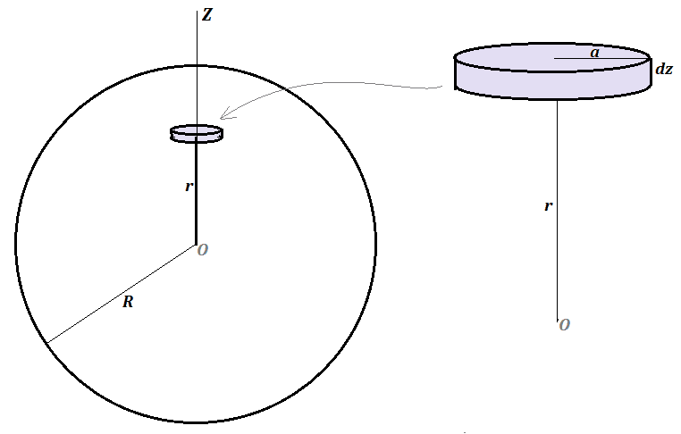

I’m uncomfortable using an entire spherical shell to deduce ##P(r)##. Instead, consider an infinitesimal circular disk of material inside the sphere as shown.
Diagram of a uniformly charged sphere of radius R centred at O, with a thin disk of thickness dz and radius a at distance r from O along the Z axis; an arrow points from a separate enlarged view of the disk to its position.
Let ##a## be the (infinitesimal) radius of the disk and ##dz## the thickness of the disk. Let ##r## be the distance from the center of the sphere, ##O##, to the center of the bottom surface of the disk. The distance from ##O## to the center of the top of the disk is then ##r+dz##. Let ##A## be the area of the bottom (or top) of the disk. So, the volume of the disk is ##dV = Adz##
The electric force ##F_z^{\rm elec}## experienced by the disk will be in the ##z## direction: ##F_z^{\rm elec} = \rho dV E(r)##.
The net pressure force ##F_z^{\rm pr}## on the disk must be equal and opposite to the electric force: $$F_z^{\rm pr} = P(r)A – P(r+dz)A = - \rho dV E(r).$$ Approximating ##P(r+dz) \approx P(r) + P’(r)dz##, show $$P’(r) = \rho E(r) = \frac{\rho^2 r}{3\varepsilon_0}.$$ I think this is what you got. But, as I mentioned above, I don’t believe your derivation is correct.
When you integrate the expression for ##P'(r)##, you need to allow for a constant of integration. If there is no externally applied pressure at the surface of the sphere, then ##P(R) = 0##. Use this boundary condition to find the constant of integration.

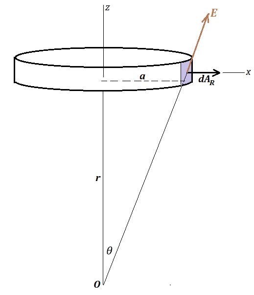

Finally, consider a small patch of area ##dA_R## of the rim of the disk:
Diagram of a thin disk with radius a, viewed from below-side, with a point O on the z axis at distance r below it, the angle theta marked, a shaded rim element dA_R, and an electric field vector E drawn outward from the rim.
Choose our x-axis in the direction of ##\vec{dA_R}##. Then ##dA_{R, y} = dA_{R,z} = 0##. So for this patch of area, $$ \left(\overleftrightarrow{T} \cdot \vec{dA}\right)_z = T_{zx}\, dA_x + T_{zy}\, dA_y + T_{zz} \,dA_z = T_{zx}\, dA_R = \varepsilon_0 E_zE_x dA_R.$$ We can approximate ## E_z = E\cos \theta \approx E## and ##E_x = E\sin \theta \approx E \dfrac{a}{r}##. [Previous sentence has been edited to correct a typo.] Also, we may approximate the distance from ##O## to the patch ##dA_R## by the distance ##r## shown in the figure (the distance from ##O## to the center of the bottom of the disk). Thus, $$ \left(\overleftrightarrow{T} \cdot \vec{dA}\right)_z \approx \varepsilon_0 E^2 \frac{a}{r}dA_R = \frac{\rho^2 r a}{9 \varepsilon_0}dA_R.$$ Summing all of the patches on the rim, $$ \int_{rim}\left(\overleftrightarrow{T} \cdot \vec{dA}\right)_z =\frac{\rho^2 r a}{9 \varepsilon_0} \int dA_R = \frac{\rho^2 r a}{9 \varepsilon_0}(2\pi a dz) = \frac{2\rho^2 r }{9 \varepsilon_0}(\pi a^2 dz) = \frac{2\rho^2 r }{9 \varepsilon_0}dV.$$ Adding this to the result for the top and bottom surfaces gives the net electric force on the disk: ##\dfrac{3\rho^2 r }{9 \varepsilon_0}dV = \dfrac{\rho^2 r } {3 \varepsilon_0}dV = \rho E(r)dV.##

@TSny, there appears to be a typo here, the rest looks reasonable... what if you used a curved element with the edges facing tangential direction instead of ##x## direction. It cannot be that the result depends on what coordinate system or what type of element is chosen...I am still checking. Thanks.
Thanks for catching the typo.
For the curved element, I still get ##\rho E dV## for the surface integral of the Maxwell stress tensor.

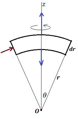

Diagram of a small curved wedge-shaped volume element of thickness dr at radius r from origin O, with a vertical z-axis, a circular arrow around it, and a blue vertical double arrow along the axis.
In the figure ##\theta## is considered small and the "rectangle" should be rotated around the z-axis to generate the volume element. I hope this is the geometry that you mentioned. The stress forces on the top and bottom surfaces (blue) are due to ##T_{rr}## while the stress force on the rim is due to ##T_{\theta \theta}## (brown).
For the force on the bottom I get ## F_z = - \dfrac {\pi \theta^2\rho^2}{18 \varepsilon_0} r^4##.
For the top I get ## F_z = \dfrac {\pi \theta^2\rho^2}{18 \varepsilon_0} (r+dr)^4 \approx \dfrac {\pi \theta^2\rho^2}{18 \varepsilon_0} (r^4 + 4r^3 dr)##.
Together, these give ##F_{\rm top+bottom, z} = \frac 2 9 \frac{\rho^2 r}{\varepsilon_0}dV##, where ##dV = \pi (r \theta)^2 dr##.
For the rim I get ##F_{\rm rim, z} = \frac 1 9 \frac{\rho^2 r}{\varepsilon_0}dV##.
So, the net force due to Maxwell stresses is ##F_z = \frac 1 3 \frac{\rho^2 r}{\varepsilon_0}dV = \rho E(r) dV##.
I realized what the issue was, I neglected the ##\sigma_{\theta \theta}## and ##\sigma_{\phi \phi}## terms in the stress tensor. The stress tensor has 3 non-zero diagonal entries and the divergence of the tensor does give the correct answer, $$(\nabla \sigma)_r = \frac{1}{r^2} \frac{ \partial r^2 \sigma_{rr}}{ \partial r} - \frac{1}{r} (\sigma_{\theta \theta} + \sigma_{\phi \phi})= \frac{\rho^2 r}{3 \epsilon_0}$$
TSny made it clear there must be contributions from terms other than ##\sigma_{rr}##. The stress tensor still holds mechanically.
