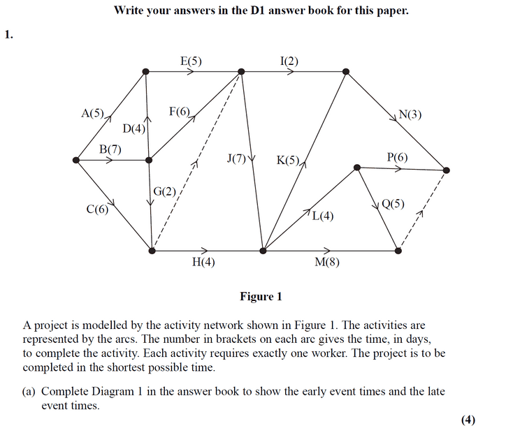

Kindly consider the attached diagram and its solution.
decision maths
Activity network diagram with nodes and arcs labelled A(5), B(7), C(6), D(4), E(5), F(6), G(2), H(4), I(2), J(7), K(5), L(4), M(8), N(3), P(6), Q(5), with some arcs dashed.

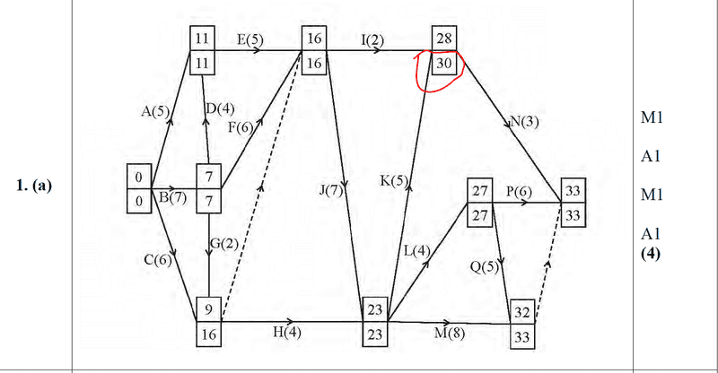

Now the steps seem to be pretty clear on this ms below;
Activity-on-arc network diagram with nodes showing earliest and latest times; a red loop highlights the node with 28 above and 30 below, next to the arc N(3) leading to node 33.
My challenge is on the highlighted, in short i note that EST is the earliest time that an activity can start. No challenge on that and by that we have to consider all dependencies. Now i can note that we have,
##B(7) + D(4) + E(5) + J(7) = 23##
##23 + K(5) =28##
that aspect is clear with me as also applies to other nodes. Now my question is the ##30## how to arrive at that? this is a new area to me but i have taken the challenge to self study.
Cheers.
aaaaaah late event time...i should be able to master that! from final node i can see that going backwards we have ##33-3=30## ...if that is correct then i will proceed.

Yes, that is the correct way to enter the late finish times, but why have you entered 11 as the early start time in the top left box? There is a different path that allows this event to start at t = 5. That is not the only error you have made.
That is not my working but a copy of mark scheme from one of the international exam boards...
Ah, I have misinterpreted the question, let me have another look.
Sorry, I was thrown by the format. The answer is correct, as is your comment

...just to get this clear. The project will take 33 days, correct. Now to my question, Calculate the maximum number of days by which activity H could be delayed without lengthening the completion time of the project?
My thinking; Earliest start ##9 +4 = 13##
Latest start ##27-4 = 23##
Therefore, Float = ##23-13=10##

No, the early start (I prefer the terms 'late' and 'early' rather than 'latest' and 'earliest') for H is 9 (the top number in its predecessor node): 13 is the early finish for H.
No, the late start for H is 23 - 4 = 19 (the late finish (the bottom number) for its successor node - H's duration).
I am not a fan of "activity on arrow" networks, particularly when times are shown on nodes. An "activity on node" (AON) network with ES, EF, LF and LS shown for each task is much easier to work with and to easily see the critical path(s) and the float for each activity.
