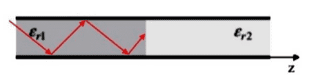

Plate separation is given as 2*10^-3 m. Waveguide propagates through two different permabilities. Find Frequency of Wave (Imgur Link with the Figure of the Problem is attached as well)
##f(cutoff) = {m}/{(2d*√μϵ)}##

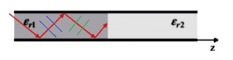

The Imgur Link of the Problem with the figure - Problem Link. I did not paste it here as the post upload quality seemed heavily pixelated for some reason.
For this problem, what I did was to divide the waveguide into 2 sections of distinct permabilities to calculate the cutoff frequency. Since the problem asks for frequency of wave specifically I calculated the range of frequencies for which the waveguide will propagate in TM Mode.
Now I am confused as to whether this approach is fine or not (I think it should be because we do not have any more data supplied with the problem). Also, is this bifurcation technique fine or should I be finding the average of the 2 cutoff frequencies.
I have attached my work. I sincerely request someone to please take a look and guide me if my method is correct or not..

From the statement of the problem, what can you say about the value of the reflection coefficient at the boundary between the two dielectrics?
Can you use this value of the reflection coefficient to figure out the angle of incidence of the TM1 waves at the boundary between the two dielectrics?
I believe that the answer to the problem will be a single frequency, not a range of frequencies.

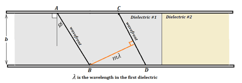

OK. Since the problem is not an assignment, I think it's OK if I show how I thought about the problem. I think it is correct. But, I could be overlooking something. You can find detailed analyses of waveguides based on Maxwell's equations on the web. [For example, see videos 19, 20, and 21 here. Video 21 deals with the parallel plate guide.] But, I don't think we need all that.

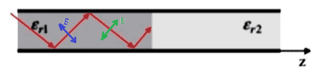

Consider the diagram given in the problem statement:
The red line can be thought of as a ray that reflects back and forth between the conducting plates. We can add wavefronts as shown below:
We have “blue wavefronts” propagating to the right and upward and we have "green wavefronts" propagating to the right and downward. For TM waves the magnetic field is oscillating in and out of the page while the electric field oscillates as shown below:
This is a very schematic picture. The blue and green wavefronts actually overlap throughout the region between the plates. See figure 24-17 in this Feynman lecture for example. So, at any point between the plates at some instant of time, the net electric field will be the superposition of a “blue electric field vector” and a “green electric field vector”. At the surface of either plate, the horizontal components of the blue and green vectors must cancel (boundary condition for E at the surface of a perfect conductor).

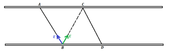

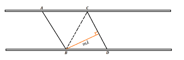

Consider the figure below:

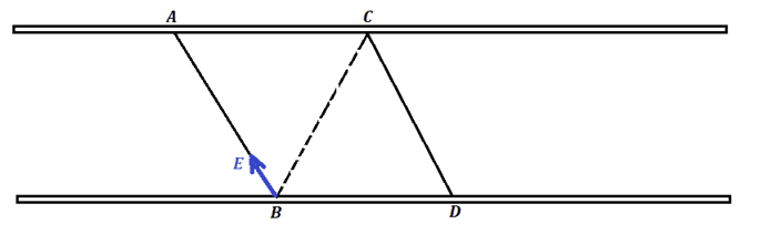

Line AB represents the edge view of an imaginary plane that extends into and out of the page and it is oriented parallel to blue wavefronts. This plane is assumed to be fixed relative to the plates and does not move with the waves. Likewise, BC is the edge view of a fixed plane oriented parallel to green wavefronts. Suppose that at some instant of time, the blue electric field at B is as shown. Then the green E-field at point B must point along the dotted line BC such that its horizontal component cancels the horizontal component of the blue E-field at B. So, it must be that at this instant of time the E-fields at B look like

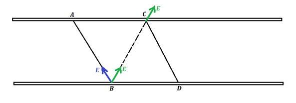

Since the dotted plane BC is parallel to the green wavefronts, the green electric field is the same at every point of plane BC. So, the green field at point C is the same as the green field at point B:

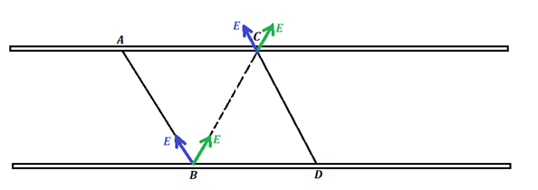

The net horizontal component of the E-field must vanish at point C. So, the blue field at C is as shown below:

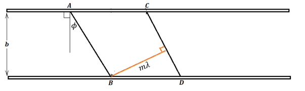

Line CD represents the edge view of a fixed imaginary plane oriented parallel to the blue wavefronts. So, the blue electric field is the same at all points of this plane. Thus, we can see that the blue field on AB is the same as the blue field on CD. That is, the magnitude and phase of the blue field are the same on the planes AB and CD. Therefore, the planes AB and CD must be separated by a perpendicular distance equal to an integer number, m, of wavelengths:
Let ##b## denote the distance between the plates and introduce the angle ##\phi## as shown:
I leave it to you to use geometry and trig to derive the important result $$m \lambda = 2b\sin \phi.$$ This is the key equation. It states that if the wavefronts are tilted from the vertical by a given angle ##\phi##, then only certain discrete wavelengths can propagate between the plates.
I also leave it to you to find how angle ##\phi## is related to the angle of incidence of the waves at the boundary between the two dielectrics. Since you have already found the angle of incidence, you can deduce the value of ##\phi##. Then you can find the allowed wavelengths for this ##\phi## from the equation above.
The problem states that you are dealing with a ##TM_1## mode. I believe the subscript 1 means you have the mode where the integer ##m## equals 1. So, ##\lambda## is determined for this problem. From this, you can easily find the frequency.

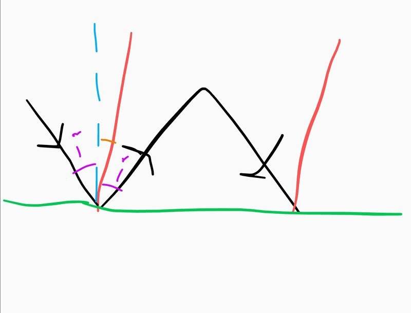

I don't see how to get 28o for ##\phi##. I defined ##\phi## as the angle that the wavefronts make to the vertical.
I believe with this definition, ##\phi## turns out to equal the angle of incidence at the interface of the dielectrics. That is, ##\phi## is equal to the Brewster angle: ##\phi = \theta_B = 36^o##.
I think the mistake I made is pretty much covered in this image. Since the green angles refer to incidence and reflection angle and the orange refers to inclination of ray with the wavefront ( ##\phi## ) I calculated it on this assertion, without factoring in my initial assumption that there is no reflected wave for the said case.
