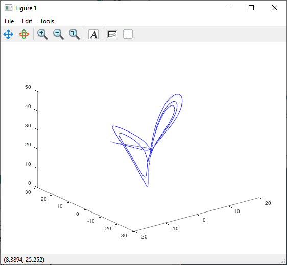

Hi,
Could it be as simple as using Lornz instead of lornz ?
( and putting t = 0 ; before the call to rk4singlestep )
[edit] Disclaimer: I don't have MatLab, used Octave instead.
Put all in one .m file :
(then t=0; wasn't even necessary)

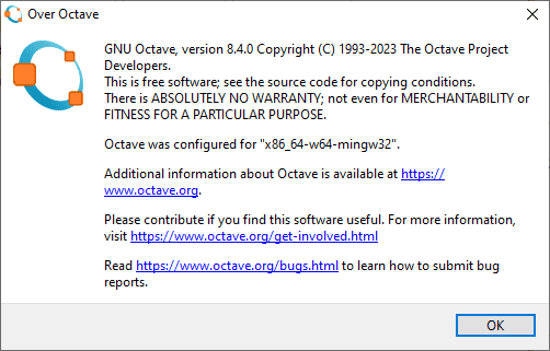

i downloaded octave but using old windows so it is saying entry point not found
I don't know what to say. Not an expert: all trial and error experience :frown:
I have W10, double-click RK_ODE.m and do
>> RK_ODE
at the command prompt; that does the trick for me.

[edit]If I first start up the Octave environment from the taskbar, I get
Code:
>> RK_ODE
error: 'RK_ODE' undefined near line 1, column 1
then bring RK_ODE.m to the editor, click Run (green arrow, F5) and add the path, it also works fine.
it worked on matlab online ( basic) ( matlab basic is the free edition of matlab) but for octave i downloaded it and didnt work (the octave didnt run)
