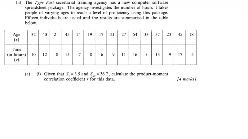

songoku
2,522
395
[tex]r=\frac{S_{xy}}{S_{x} S_{y}}[/tex]
[tex]S_{x}=\sqrt{\Sigma(x-\bar{x})^2}[/tex]
I have calculated the value of Sx several times and I got 43.3 but the answer key said that Sx = 11.2
1. Is my formula correct?
2. If yes, is my calculation correct?
Thanks
43.3 is larger than the largest deviation from the average, it cannot be the standard deviation.
I think there is a prefactor missing in your formula for S_x.
I just found out that my formula is wrong.
What do you mean by "43.3 is larger than the largest deviation from the average" ? Please explain because I really want have that kind of insight :smile:
Thanks
The standard deviation is a measure for the "typical", or "average"* deviation from the mean. You have a mean somewhere at ~30 (guessed), so the largest deviation from the mean is about 24. The typical deviation cannot be larger than this.
*squared average, to be precise
