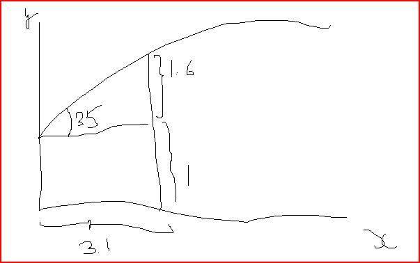

A construction worker stands in a 2.6m deep hole, 3.1m from the edge of the hole. He tosses the hammer to a person outside the hole. If the hammer leaves his hand 1m above the bottom of the hole at an angle of 35, what is the minimum speed needed to clear the edge.
Why does the book states the answer = 11m/s?
This is really frustrating!
I am getting 7.8...
Draw a sketch of the problem. This may help you setting up the equations of motion. You should be able to determine the book's solution.

The book has given the sketch.
In fact, the book has given the equation(in symbolic expression) and stated the answer is 11m/s but upon substituting the x and y coordinatate of 3.1m and 1.6m respectively, I don't arrive at 11m/s.
The book has given a sketch too.

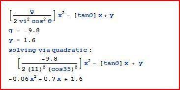

I'm sure post 1 is right. I think the issue might be that on my calculator I did (2cos35)^2 instead of 2cos(35)^2
I'm getting 10.036m/s
x = vcos(theta).t
y = vsin(theta).t - 0.5gt^2
t = x/(vcos(theta))
y = vsin(theta)[(x)/vcos(theta)] - 0.5g[(x)/vcos(theta)]^2
y = xtan(theta) - [(g)/(2v^2 (cos(35)^2))
v = SQRT[(gx^2)/(2cos(theta)^2(xtan(theta)-y))
Sub x = 3.1 and y = 1.6
g = -9.8
It's giving me 10m/s and not 11m/s

I have found v to be 11m/s.
To find where the hammer lands:
This is a very juvenile question to ask but is the a, b and c values correct?
Solving via quadratic, I'm not getting x= 3.1 or x = 8.7.
It's a very simple problem but this question is taking me more than 1 day to solve!
Solving via quadratic, I'm not getting x= 3.1 or x = 8.7 but these 2 values are what the book states.
