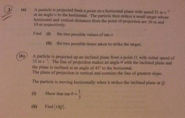

Here is the problem (Q3 (A));
Here's what I have so far;
Any help would be appreciated, thank you!
It appears you made an algebra error when you went from ## 21 \cos \alpha = \frac {30}{ t} ## to ## \cos \alpha = \frac {630}{ t} ##.
Also, I would first find your time of impact based on your horizontal component.
With that time of impact, you can make an expression that is in terms of alpha only.
Yes I realized this after I posted, I'll try that, thanks!
I made a substition of x = cos^2(alpha) and manipulated it into a quadratic equation to get the two solutions.
part b comes right out of part a if you have already solved for time of impact.
Aaron,
Something else to note: If you have the expression ##\tan \alpha = \frac{A}{B}##, then you cannot conclude that ##\sin \alpha = A## and ##\cos \alpha = B##.
Could you elaborate on this a bit? Not quite sure what you mean..
Do you have an expression that can be written as some trig functions of alpha = 0?
Use sin = sqrt(1-cos^2) to convert everything in terms of cos.
