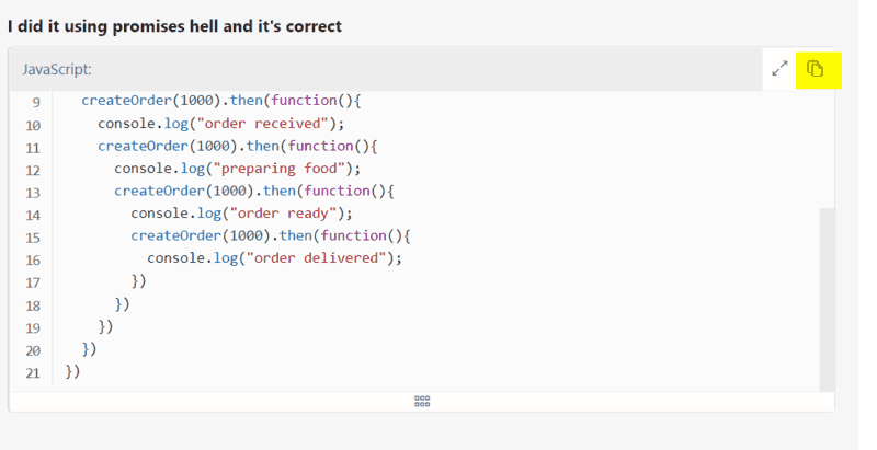

I did it using promises hell and it's correct

Dry run:
1) Wait 9s till promise is resolved, then print "order created".
then
2) Wait 1s till promise is resolved, then print "order received".
then
3) Wait 1s till promise is resolved, then print "preparing food".
then
4) Wait 1s till promise is resolved, then print "order ready".
then
5) Wait 1s till promise is resolved, then print "order delivered".
I must say I kinda get why this works (The "then".."then".."then".."then" makes it clear). But I don't understand why the first code block doesn't work.

In the second example, you ask to do the next step only after the previous promise is resolved (activating the "then" function). So for the code to find out about the next promise to execute, it has to wait for the signal of the "parent" promise.

In your second example, you are instead using repeated calls to .then to control the order in which the print statements execute, as well as using the timers to control the delays between them. That's why your "dry run" is correct for this case.
