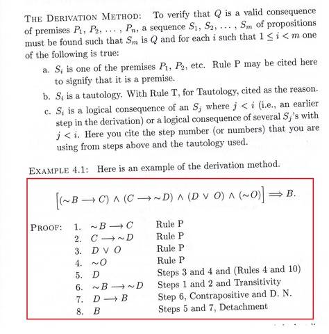

Please take a look at this proof:

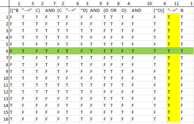

The thing I do not get is how they can do it so fast. If I were to prove this using a truth table, I would have to use 16 rows, because of all the possibilities, however they seem to not have to take into account a lot of the possibilities when they prove this.
For me it looks like they have assumed that:
[itex]\neg[/itex]B→C is TRUE
C→[itex]\neg[/itex]D is TRUE
D[itex]\vee[/itex]O is TRUE
[itex]\neg[/itex]O is TRU
But how can they just do this?
I made the truth table, am I correct to assume that the proof above, they only looked at row six in the truth table, many other possibilities were not considered? How can they just look away from these possibilities? Do you agree that they only considered row six in their proof?
Yes, because that is what the symbol "##\implies##" means: ##[A_1 \wedge \cdots \wedge A_n] \implies B## is true if assuming the Ai to be true leads to B necessarily being true. Whenever ##A_1 \wedge \cdots \wedge A_n## is not true, i.e. one or more of the Ai are false, ##A \implies B## is true by definition (check your truth table).
Alternatively, you can do a proof by contradiction: the statement is equivalent to ##\not B \implies \not [A_1 \wedge \cdots \wedge A_n]## (of course, you would have to prove this first, e.g. by making the truth tables of ##A \implies B## and ##\not B \implies \not A##). However, you need to develop the logic a bit more formally to get that - in particular you need to introduce assumptions.

Thanks, what I find confusing is when I can assume things to be true in a proof, and when it is not ok to assume things to be true in a proof.

They don't look at all the possibilities because of the Law of the Excluded Middle: A or ~A. In (Aristotelian) logic, everything is either true or not true. If it can't be not true, it is true. Think of Sherlock Holmes' quip:
If you have eliminated the impossible, whatever remains, however improbable, must be the truth.
We can now understand what was meant by this.
