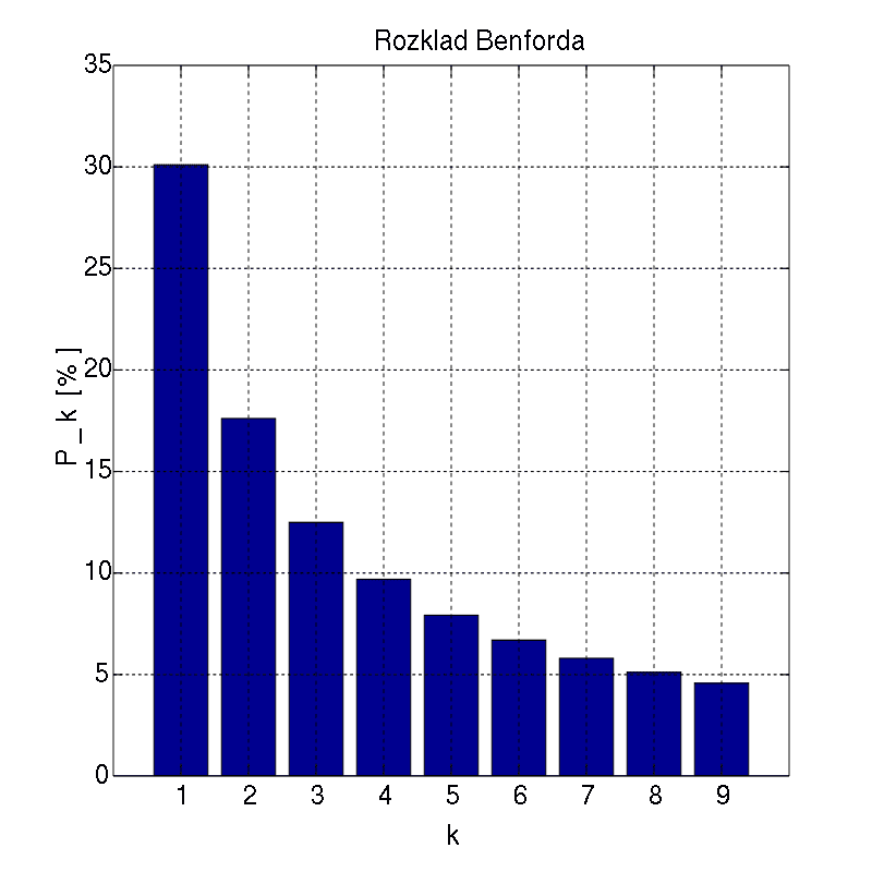

My memory seems cloudy of late but one application involved a seeded RNG that produced numbers between zero and one that met the requirements for randomness. The application programmers used simple arithmetic to produce digits from 1...10 to produce CFD test data but the requestor was not satisfied with the output.
I applied Benford's distribution to weight the generated data (digits) to more accurately mimic actual fluids, similar to this table:
A colleague really improved what she called my "brutal force" methods by subtle reiteration of the weighting algorithm to simulate more natural data streams.
