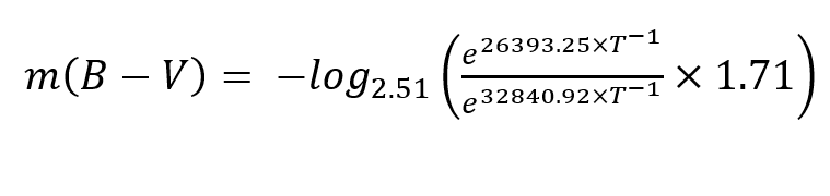

i have an equation like this:
Given m(B-V)= 1.2 +- 0.2
How do you calculate the uncertainty in T? (btw, I solve T using graphs by finding the intersection point)
My idea was first to calculate T when m(B-V) =0.2, and I then calculate T when m(B-V)= 1.2 + 0.2(its uncertainty). and then find the difference between the two T. Your help would be greatly appreciated

Your attachment cannot be viewed.

ughh thanks for pointing that out, sorry!
There is the simple way -- assume that the solution for T is monotone in m(B-V). Evaluate T for m(B-V) = 1.4 and for m(B-V) = 1.0. See what the range is.
Evaluating the error range by looking at a partial derivative of T with respect to m(B-V) and then multiplying by the error bound on m(B-V) sounds like way too much work and may not even be accurate.

You can invert the equation and solve for T in terms of m(B-V). Then do standard error propagation. Use
$$\frac{{e^{\frac{a}{T}} } } {{e^{\frac{b}{T}}}}=e^{\frac{1}{T}(a-b)}$$

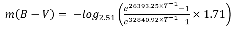

Wait, I'm really sorry, the equation supposed to have minus one after e, that's why i can't solve for T in terms of m(B-V) numerically. sorry again for uploading the wrong eq. thanks for the reply
That makes a big difference. Thanks for the clarification.

if we use the above eq. when
m(B-V)= 1.2, T= 3930
when m(B-V)= 1, T= 4420
when m(B-V)= 1.4, T= 3530
so the uncertainty of T= is 4420-3530?
OR
we have to do it separately on both sides?
upper uncertainty= 3920-3530
lower uncertainty= 4420-3920
Thanks

if we use the above eq. when m(B-V)= 1.2, T= 3930
For m(B-V) = 1.2 I got T = 4960 for log base 2.51. The natural log gave me 3714 which is closer to your value of 3930.
