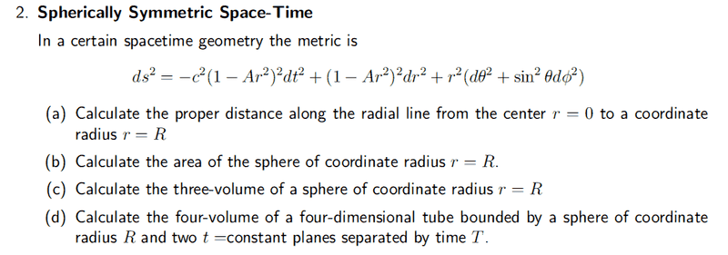

(a) Find the proper distance
(b) Find the proper area
(c) Find the proper volume
(d) Find the four-volume
Typeset homework problem 2 on spherically symmetric space-time, giving the metric ds^2 = -c^2(1 - Ar^2)^2 dt^2 + (1 - Ar^2)^2 dr^2 + r^2(dtheta^2 + sin^2 theta dphi^2) and parts (a) to (d) asking for proper distance, area, three-volume and four-volume.
Part (a)
Letting ##d\theta = dt = d\phi = 0##:
[tex]\Delta s = \int_0^R \left( 1-Ar^2 \right) dr = R \left(1 - \frac{AR}{2} \right)[/tex]
Part (b)
At ##r=R##:
[tex]A = R^2 \int_0^{2\pi} d\phi \int_0^{\pi} sin \theta d\theta[/tex]
[tex]A = 4\pi R^2[/tex]
Part (c)
[tex]V = \int_0^R r^2 \left( 1 - Ar^2 \right) dr \int_0^{\pi} sin \theta d\theta \int_0 ^{2\pi} d\phi[/tex]
[tex]V = \frac{4}{3} \pi R^3 \left( 1 - \frac{3}{5} AR^2 \right)[/tex]
Part (d)
[tex]V_4 = c\int_0^R r^2 \left( 1 - Ar^2\right)^2 dr \int_0^T dt \int_0^{\pi} sin \theta d\theta \int_0^{2\pi} d\phi[/tex]
[tex]V_4 = \frac{4}{3} \pi R^3 \cdot cT \cdot \left( 1 - \frac{6}{5}AR^2 + \frac{3}{7}A^2R^4 \right)[/tex]Is this the correct method? This question seems a little too straightforward..
I would guess that, if you look forward in your text, you will find this metric gets a lot of work. For example, you may be doing some interesting work studying the place where r^2 = 1/A.
So quite likely this is just a warm-up getting some interesting features of the metric.
