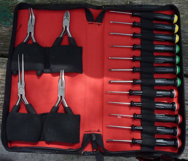

Good response, pantaz, and good illustrations. I use another method, too, if I can. Grab the back side of the clip (away from the open end) with a tiny pair of needlenose pliers and just pull it off the shaft. A co-worker gave me a Sears gift certificate one year, and I used it on this set of mini-tools. They get 'way more use than I ever expected.
