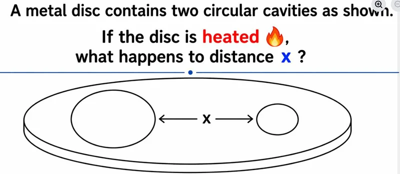

Under uniform heating, what happens to distance X?
(What? No Grade School prefix? :) )
Apologies for the lowest form of physics question: a quiz on social media.
Does distance X
a. increase
b. decease
c. stay the same?

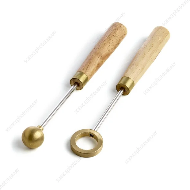

I did the simple version of this in grade 7 science class:
When both are in relative thermal equilibrium (say, room temperature) the ball does not fit through the ring.
Heat the ring and the ball slips through.
The experiment proves that, in this simple case at least, the ring expands uniformly, i.e. the inner edge of the ring expands outward, not inward.

Uniform expansion means that all distances increase. So if you assume that, the answer is a.

Every one-dimensional measurement increases by the same ratio. Put two marks anywhere on the disk and the distance between them will increase as described by ##\Delta L=L_o\alpha \Delta T##. The holes in the disk are a distraction.
DaveC426913 said:
You know that and I know that, but that's a metaphor, not an explanation.
Make the radii of the holes tend to zero: we have a body tending to look close to a coin.
If all the molecules of coin increase at once (uniform heating), its shape expands uniformly.
Make the radii of the holes tend to the radius of the disc: we have a body tending to look close to the ring shown in post 1.
If all the molecules of ring increase at once (uniform heating), its shape expands uniformly (increasing its internal diameter.
Something I noticed many people assumed: nowhere does it say they're "holes" they're "cavities", which does not suggest they cut all the way through. That is verified by the diagram, which does not indicate the inner circles have any substantial depth. They are depressions , not holes.
From a fundamental materials point of view, if the metal is isotropic and the sample in not constrained or loaded mechanically (essentially isotropic state of stress) in any way, then the sample experiences a homogenous isotropic strain, with, for small temperature changes, the strain being proportional to the temperature change.
My point is, they are a distraction. Doesn't matter how deep they are. The distance ##x## will increase.
Put two marks on the disk and measure the distance ##x## between them. The value of ##x## will increase regardless if there are holes or cavities next to the points, between the points, or anywhere else; or even if one or both of them is not there.

An easy way to view (and teach) such problems is to consider the missing material. Here is what I mean.
  1. Start with two identical metal disks. Disk A is the control and disk B the object of investigation.
  2. Allow disks A and B to reach equilibrium at common temperature T1.
  3. Cut out of disk B two coin-like smaller disks which may or may not leave cavities or holes behind; it doesn't matter.
  4. Cut out a wire along distance "x"; again it doesn't matter whether a slit or cavity is left behind.
  5. Note that you can remove and reinsert any of the cut-out disks and the wire "x" in disk B. When all pieces are in, disks A and B look identical.
  6. Raise the common temperature of disks A and B (including the cut outs) to T2.
  7. Note that you can remove and reinsert any of the cut-out disks and the wire "x" in disk B. When all pieces are in, disks A and B look identical and have increased diameters at the new, increased temperature.
  8. Draw your conclusions.
I think that problems of this type illustrate what I call the "window" preconception. We are used to observing the world through windows, television screens, computer monitors, etc. where depicted objects appear larger when they move closer whilst the plane of the frame through which we observe them remains fixed in size.
So when we are asked what happens to the hole in the disk when the disk is heated, we know that the material of the disk has to expand because it is heated, but since we impulsively assume that the disk circumference is fixed (just like a ship's porthole), the hole in the disk must get smaller, no?
