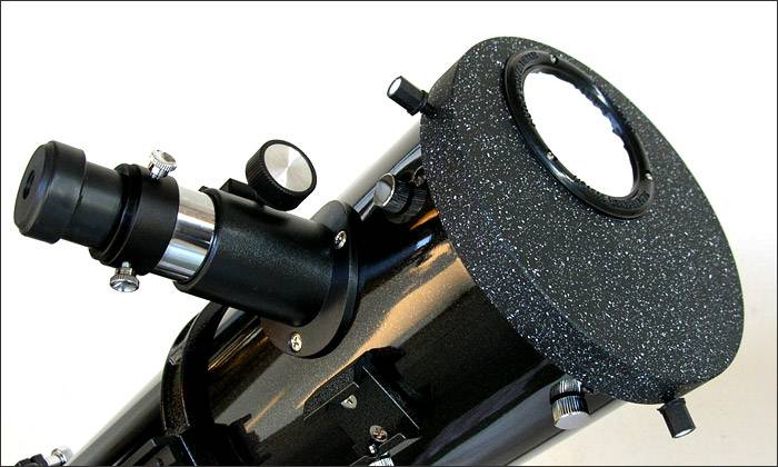

Wait, I've seen some transit setups without any filters at all where projection was used. Can that only be done with pure refractors?
Close-up of a Newtonian reflector telescope tube with a black textured dew shield-style front cover over the open aperture, a black eyepiece and focuser on the side, and adjustment knobs on the tube.
I think I could do something like that fairly easily. Looking at my secondary, there is only about 1.5 in clearance, and the only dill bit for circular holes I have on hand is a 15/16".
So, I'd be stopping the aperture down to 15/16", with 3 layers of mylar. Is that enough? Should I throw a layer of glass or polycarbonate in there as well? I think the only plastic parts in my scope are the baffle down the main tube. But I'm not sure about the adhesives and as mentioned the IR effects on the mirror/CMOS sensor is pretty scary.
My field of view is .94 x .62 degrees. Probably the longest time pointing directly at Sun would be during focusing.
If that is your 6 incher there I would humbly suggest that the hole is too big. I have a factory cover for my 5 inch with a smaller hole and it is just enough to make a bright moon comfortable to look at. Just a suggestion; Why not make some smaller holes in pasteboard for example and tape them over the hole that you have. Start small and work up carefully. Of course you need to use a very dark filter over the hole as mentioned above. I am using two lenses from old fashioned welding goggles.
That pic is not my telescope, but that off-axis solar filter is what I'm trying to make. I think I will drill 15/16 inch hole then cover with various pasteboard holes a bit smaller as you say, thanks for the tip.

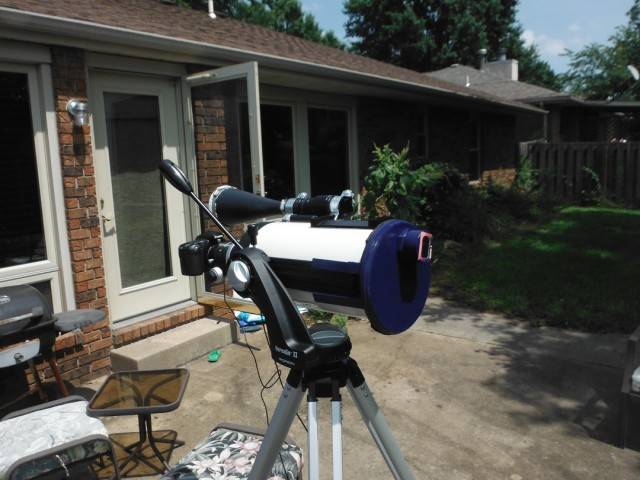

I've got my aperture stop all constructed with a 15/16" hole. I'm starting to think the best idea would be to just cut my eclipse goggles in half and use that. Each eye has a 1.5" by 1.5" of the material.

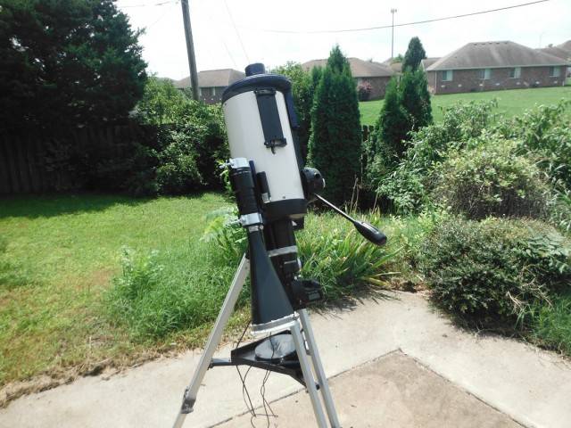

Think I've got something that will work. Here's a few quick shots and a horribly off-center showing color for Sun.

Hand holding a round black foam disc with a central circular hole and three screws, mounted in front of a blue-painted wooden frame, on a sunny sidewalk near a telescope tripod.
Just need to rig up a good aiming solution and think I'll be set. :)
