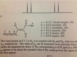

It asks you to identify the shift and nature of the protons in the molecule.

I cannot understand what makes C a multiplet. I suppose I am confused about the concept of a multiplet in general.
Sorry, no picture.
sorry. what about now?
Two d protons and single b proton. Together they should yield doublet of triplets (or triplet of doublets).
why is D not a multiplet ?
