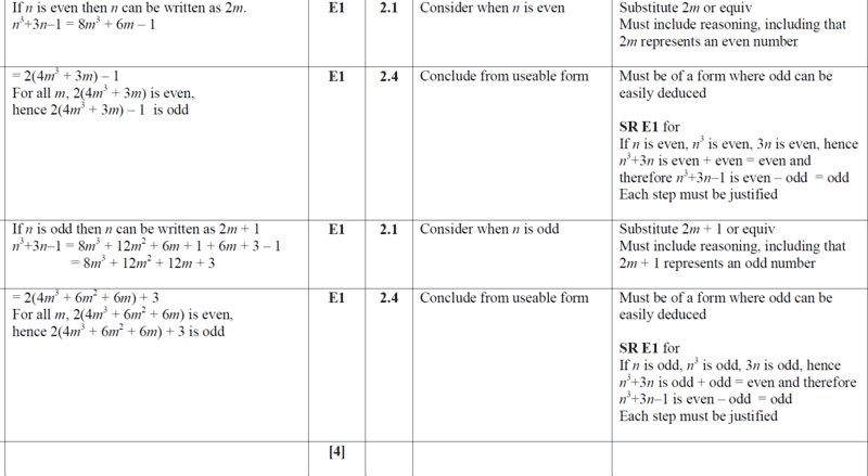

Prove algebraically that ##n^3+3n-1## is odd for all positive integers ##n##.
Algebra
This is a past paper question; Find the solution here; Well understood
Now i was just thinking along this lines;
Let ##n=x##,
then ##f(x)=x^3+3x-1##
##f(x) =x(x^2+3)-1##
since ##x∈ℤ^{+}## then ##x(x^2+3)## will always be even implying that ##x(x^2+3)-1## is odd.
Would this approach hold or i have to stick with ms? Thanks.

@malawi_glenn how to show this directly? I just looked at parity...some work though required...you still have to let ##n=2k+1## for odd numbers and let ##n=2k## for even numbers. Note that this was already used on the attached mark scheme guide.

That all fine, except that notation may not be part of the course. Moreover, the marking scheme suggests to me that an approach from first principles is expected.
Reply
Would a student be penalised for using an approach other than what was expected? Like in this case using parity? Or it depends on examining body...

Then the only consideration should be getting maximum possible marks. You can do this by using the methods that are taught in the syllabus to solve the problem, and the method that is taught for solving questions of the form "prove something is odd for all ## n \in \N ##" is to consider odd and even separately.
This appears to be from a public exam similar to a UK 'A'-level. Markers are paid about £3 per script for these, which leaves seconds to decide on each mark: they do this by comparing it to the marking scheme, so make it easy for them to give you full marks.
The instructions to markers will say something like
If a student uses a method which is not explicitly covered by the marking instructions the same principles of marking should be applied. Credit should be given to any valid methods. Examiners should seek advice from their senior examiner if in any doubt.
so if you do go "off-piste" you might be lucky, but if the marker is falling behind on their quota you might not. It is typically this kind of thing that gets picked up in a re-mark, but why go to the time, trouble, cost and risk of a re-mark when it is easier to use the method you were taught first time? There are no marks for being a smart-arse.
