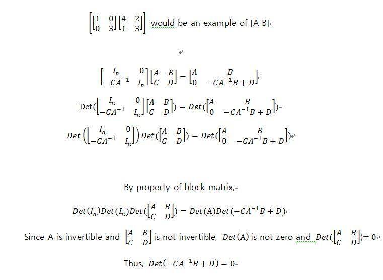

if A B C D are nxn matrices such that rank(A)=rank([A B])=n ([A B] : 2nx2n matrix)
[C D] [C D]
we want to show that D=CA‑¹B (A‑¹: inverse matrix of A)
this is what i have tried:
[In 0] [A B] = [A B ] (here, In refers to identity nxn matrix)
[-CA‑¹ In] [C D] [0 -CA‑¹B+D]
det( [In 0] [A B] ) = det ( [A B ] )
det( [In 0] ) det( [A B] ) = det ([A B ] )
by property of determinant of block matrix,
det(In)det(In)det( [A B] ) = det(A)det(CA‑¹B+D)
[C D]
since A is invertible and [A B] is not invertible, their determinents are not zero and zero respectively
[C D]
Thus, det(CA‑¹B+D)=0
If i can show that CA‑¹B+D=0, then my proof ends.
But i can't show this.
can anyone show that CA‑¹B+D=0?

Ok i have rewritten my question since it looks very confusing

The calculation looks correct, but I don't understand why you're doing it. You still haven't stated the problem in a way that makes sense. In particular, you haven't said anything to indicate that C and D are anything but arbitrary n×n matrices.
I want to show that det(D-CA‑¹B )=0 implies D-CA‑¹B=0
But i don't know how. Or are there any other ways?
But you haven't given any conditions on C and D. What if for example ##A=I## and ##B=0##? Then ##D-CA^{-1}B=D##. So you're trying to prove that the arbitrary(?) matrix D is zero.

No. My gut feeling is that it is wrong. Saying that the determinant is 0 usually just means that a non-trivial set is mapped to zero. I don't see how to prove that everything is mapped to zero. I have my doubts.
1) I think the concentrating on the determinants is a mistake. It looses too much information. Saying that a determinant is zero is not a strong enough statement to draw the conclusion. I think that the initial conditions imply that C, D, and B are transformations of A, where all the transformations are invertible. I think you should use that in your proof instead of determinants.
2) I also think that there is a sign error. If we define B, C and D as B = C = D = A, doesn't that satisfy the initial conditions? But then we would be trying to prove that CA‑¹B+D = 2A =0. That can't be right. Oh. I see that the original problem was to show that D = CA‑¹B. So that is CA‑¹B - D =0.
