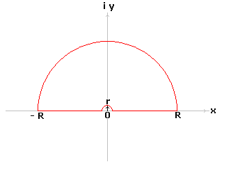

A milestone of complex analysis is the use of Cauchy Integral Theorems for solving integrals that are 'resistent' to 'conventional' attaks. In particular the first of these theorems extablishes that if a complex variable function is analytic inside and along a closed path C is...
$\displaystyle \int_{C} f(z)\ d z = 0$ (1)
Now we computing (1) in the case $\displaystyle f(z)= \frac{e^{i\ z}}{z}$ when the path is represented in the figure...
... and when $R \rightarrow \infty$ and $r \rightarrow 0$. The Jordan's lemma extablishes that the integral along the 'big circle' tends to 0 if $ R \rightarrow \infty$ , so that, tacking into account (1), we conclude that is...
$\displaystyle \int_{- \infty}^{+ \infty} \frac{\sin x}{x}\ dx = \lim_{r \rightarrow 0} \int_{0}^{\pi} e^{i\ r\ e^{i \theta}}\ d \theta = \pi$ (2)
Details have been omitted but it's clear that this approach is more complex and less elegant that the Laplace Transform approach...
