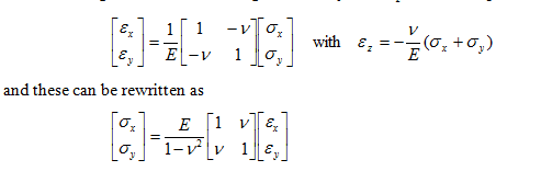

How does the first step transform into the second step. I have no idea :(
Two matrix equations: strain vector [εx, εy] equals (1/E) times [[1, -ν], [-ν, 1]] times stress vector [σx, σy], with εz = -(ν/E)(σx + σy); below, stress vector [σx, σy] equals E/(1 - ν²) times [[1, ν], [ν, 1]] times strain vector [εx, εy].
Consider:
If A = B*C
then B-1A = B-1B*C
But B-1B = I
so that C = B-1A
I still don't understand where the E/1-v^2 comes from.
also its asked to prove shear strain, ill use this symbol for it. ω
it asks to prove τxy (tau xy) = (E/1-v^2) [((1-v)/2) (ωxy)]
given ωxy = 1/G (τxy)
Any help? :(
Starting with the first equation, first multiply the 1/E into the 2x2 matrix. Then find the inverse of that matrix, then factor out the constant term.
