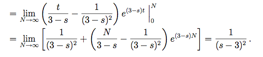

Two-line worked limit: first line is the limit as N goes to infinity of (t/(3-s) - 1/(3-s)^2) e^((3-s)t) evaluated from 0 to N; second line is the limit of [1/(3-s)^2 + (N/(3-s) - 1/(3-s)^2) e^((3-s)N)] = 1/(s-3)^2.
I can understand step 2 to 3, but I can't get step 1 to 2. For simplicity sake we'll just call e^(3-s)t = N since it will = N anyway ultimately.
I think the answer should be
[N/3-s - 1/(3-s)^2)N - (0 - 1/(3-s)^2)0
The second term is still multiplied by zero. So the answer should be infinity.
Your variable is t. And its limits are from 0 to N. When t=0, you have
[tex]e^{(3-s)t} = e^0 = 1[/tex]
And not 0, as you got...
