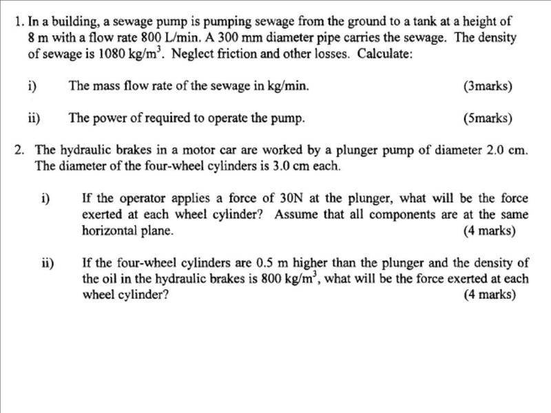

qpzm77gg
My answers in Q1 , (i) 861.6 kg/min (ii) 1126.97Watt
My answers in Q2 , (i) 67.5N (ii)2.77N
My answers are correct or not?
Thanks.
Above is close.
Above is incorrect.
