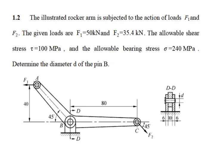

The illustrated rocker arm is subjected to the action of loads F1 and F2. The given loads are F1=50kN and F2,=35.4kN. The allowable shear stress τ=100 MPa ,and the allowable bearing stress σ=240 MPa. Determine the diameter d of the pin B.
τ= V/A, σ = F/t*d

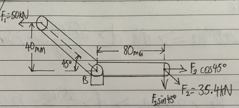

Hi, just need somebody to check my homework solution. Not entirely sure of my answer. My teacher used Mechanics of Materials by RC Hibbler, but I could not find an example question to solve this homework question.
Equilibrium at pin B
Take moments about B:
F_1 \cdot 40 = F_2 \cdot (80\sin45^\circ)
50 \cdot 40 = 35.4 \cdot 56.57 = 2000\ \text{kN·mm}
Force equilibrium:
\sum F_x = 0:\quad R_{Bx} + 35.4\cos45^\circ - 50 = 0 \quad\Rightarrow\quad R_{Bx} = 25\ \text{kN}
\sum F_y = 0:\quad R_{By} - 35.4\sin45^\circ = 0 \quad\Rightarrow\quad R_{By} = 25\ \text{kN}
R_B = \sqrt{25^2+25^2}=25\sqrt{2}=35.36\ \text{kN}
Pin design (double shear) – two outer plates t=6 mm, center plate t=10 mm
Shear:
\tau = \frac{R_B/2}{\pi d^2/4} = \frac{2R_B}{\pi d^2} \le 100\ \text{MPa} \quad\Rightarrow\quad d \ge \sqrt{\frac{2\times35360}{\pi\times100}} = 15.0\ \text{mm}
Bearing – center plate:
\sigma_b = \frac{R_B}{d\cdot10} \le 240\ \text{MPa} \quad\Rightarrow\quad d \ge \frac{35360}{2400} = 14.73\ \text{mm}
Bearing – outer plates:
\sigma_b = \frac{R_B/2}{d\cdot6} = \frac{R_B}{12d} \le 240\ \text{MPa} \quad\Rightarrow\quad d \ge \frac{35360}{2880} = 12.28\ \text{mm}
Result shear governs
\boxed{d = 15\ \text{mm}}
  • Engineering drawing of a rocker arm with pivot points A, B and C, loads F1 and F2 applied, dimensions 40, 80 and 45 degree angle, and detail D-D showing pin B with plate thicknesses 6, 10, 6.

  • Hand-drawn free-body diagram of a rocker arm pivoting at point B, with F1 = 50 kN applied at the upper left, a 40 mm vertical dimension, a 45° inclined member, an 80 mm horizontal dimension, and F2 = 35.4 kN at the right with components F2 cos 45° and F2 sin 45°.

Your equations and results are correct.
I would skip the calculation of the moments in balance, because the pin B is not resisting any of it.
