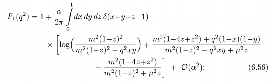

In that case, I must be making some sort of mistake. I have successfully found the Dirac form factor as given on page 196 of Peskin and Schroeder:
##m## is the electron mass and ##\mu## is a fictitious photon mass.
However, focussing on the logarithmic piece, it is easy to see that the amplitude actually goes down as the magnitude of ##q^2## increases (it's a space-like momentum), and furthermore I end up getting a ##\beta##-function which is wrong by a factor of ##-3/2##.
It's been a fair few months now, and I am still struggling to find an example of how this calculation of the QED vertex can reveal the positive beta function of QED. Does anyone know what I'm doing wrong? I'm assuming P&S's result is correct, and I have reproduced it.

I'm familiar with the self-energy calculation yielding the ##\beta##-function, and the argument for why that happens (Peskin & Schroeder), but what I'm looking for is getting the ##\beta##-function from the vertex, as we would with something such as ##\phi^4## theory where we don't have the Ward-Takahashi identities, if possible as HomogenousCow suggested, or if not possible, why it isn't. I understand you don't need to do it this way, but I can't get a three-point function which gives rise to the correct result (agrees with P&S, but the resulting ##\beta##-function is out by a factor of -2), which is what is baffling me.
